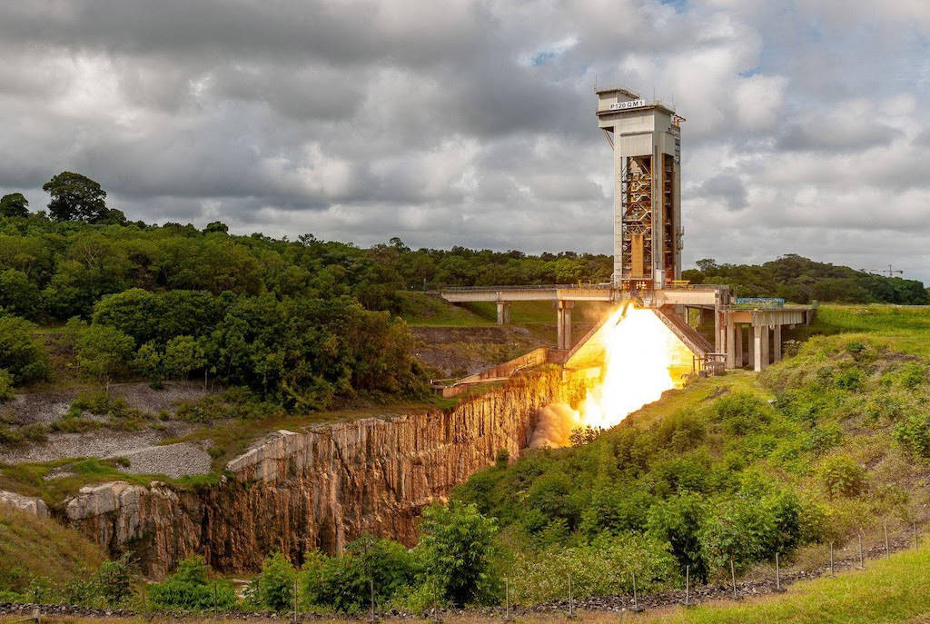

Recently, the world watched as international hackers disabled a critical fuel pipeline on the east coast of the U.S., holding it for ransom. Imagine what havoc they could wreak with a 44-foot-long spacecraft booster filled with 142 tons of solid rocket propellant (Figure 1). The Ariane engineers needed a control solution that provided a neat convergence of IT, OT and high-speed DAQ technology, and provided the best possible cybersecurity.
Figure 1: The rocket test stand at Guiana Space Centre (CSG), French Guiana. Courtesy: ESA-CNES-ARIANESPACE

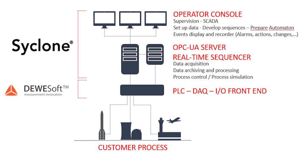

The system selected for the BEAP (solid booster test bench) was the EES-CLEMESSY Syclone, a scalable control and command software configured like a toolbox. This modularity makes it possible to develop a customized solution that can be adapted to a wide variety of applications and environments. Syclone combines the worlds of supervision, real-time process control and physical hardware. Syclone interfaces with the operators and runs the real-time sequencer as well as the server.
For the high-speed DAQ elements, EES-CLEMESSY selected DEWESOFT, a maker of DAQ hardware and software. Unlike previous stand-alone DAQ systems, the Dewesoft data acquisition and control systems are not only used as DAQ systems, but also serve data to the Syclone control system in real time (Figure 2).
The decision support system provides operators at the Guiana Space Center with a map of all danger zones during high-risk operations such as launching a rocket or test firing engines. The objective of the system is to analyze and cross-check meteorological and pyrotechnical parameters over an area of 850 square miles and display information in real time for up to 10 dangerous operations simultaneously conducted.
Figure 2: Top level system overview. Courtesy: Dewesoft

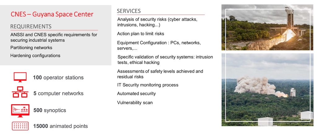

Build in cybersecurity from the ground up
From the beginning of system integration, EES-Clemessy decided to address cybersecurity issues in the OT and IT systems, even though they don’t always share the same level of security, or the same requirements in terms of confidentiality, integrity and availability (CIA).
Robust cybersecurity begins by reducing the digital “attack surface” to the bare minimum required by operational requirements. EES-Clemessy applied a strategy called “defense-in-depth” to the rocket testing system. Defense-in-depth means addressing the cybersecurity at every layer of the system, each layer implementing mostly independent security measures (Figure 3). This is what the layers of the system look like:
Figure 3: Securing the BEAP control and command system. Courtesy: Dewesoft
