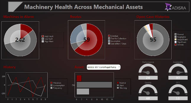

Storytelling. Data visualization using traditional HMI/SCADA and dashboards show operators what is happening, but not why. Data storytelling is a method for communicating the why with a compelling narrative. Data storytelling puts information in context, reducing the chance of incorrect interpretation (see Figure 2).
