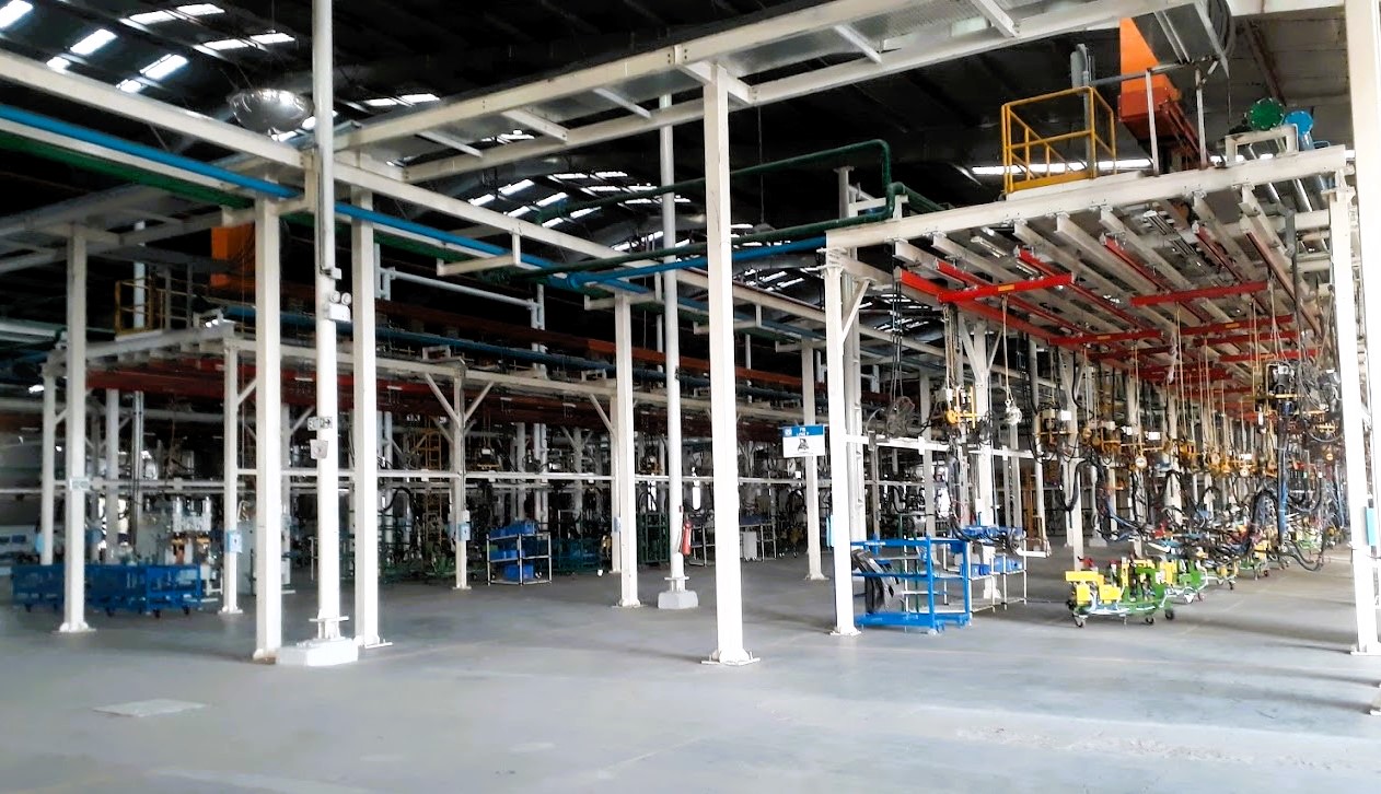

Figure 1: Interior of a large industrial facility with metal beams, pipes, and machinery, featuring a spacious layout and a concrete floor. Courtesy: NEXGEN
