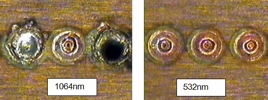

As discussed, material reflectivity must be addressed to achieve a good, strong laser micro weld on copper. As shown on Table 1, reducing the wavelength from 1064nm to 532nm significantly reduces the reflectivity of copper and other conductive materials. The 532nm (green) wavelength enables consistent coupling into the copper and stabilizes welding. Figure 1 shows the comparison of 1064nm and 532nm wavelength welding of uncoated copper. At 532nm, the laser couples into copper as 1064nm couples into steel. Therefore, successful micro welding of copper can be achieved if a 532nm laser is used.
This wavelength can be achieved in two ways. Most common is to use a q-switched laser, but such a laser does not have sufficient pulse energy to weld.
A more novel approach is to use a regular pulsed Nd:YAG laser, which offers 532nm light at 1.5 kilowatt (kW) peak power with up to a 5 milliseconds (ms) pulse width. This provides enough weld energy to penetrate approximately 350 microns thick copper, which is sufficient for most micro welding applications. Another additional benefit of using a pulsed Nd:YAG laser delivered through a fiber is that the beam has low brightness. This promotes even absorption across the focus spot, preventing hot spots at the center of the weld that may cause instability.
