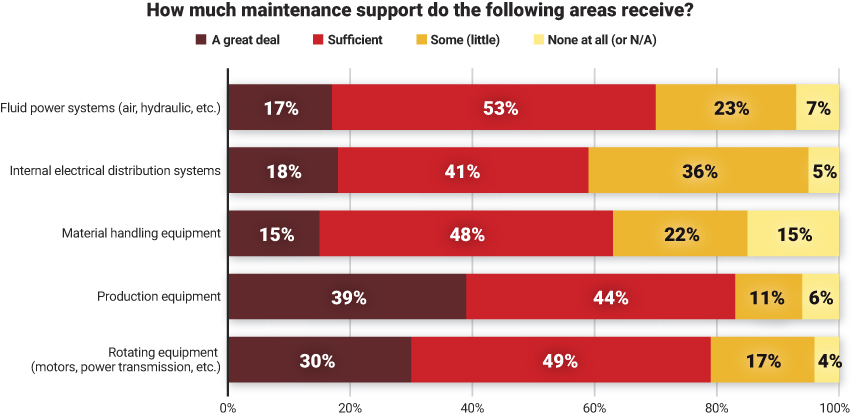

How much maintenance support do the following areas receive?

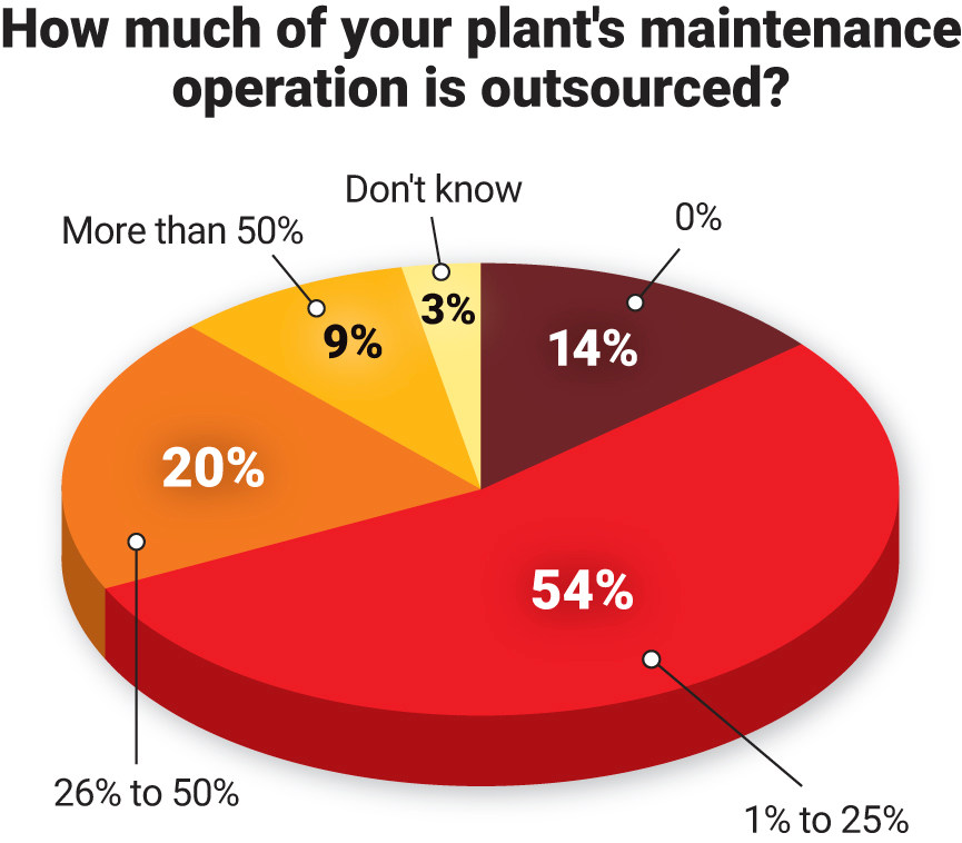

How much of your plant's maintenance operation is outsourced?

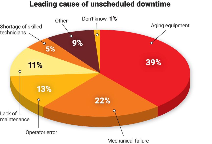

Leading cause of unscheduled downtime.

  • Eighty-six percent of facilities outsource some or all of their maintenance operations. Since 2021, 29% of facilities have increased or greatly increased their use of outsourced maintenance services.

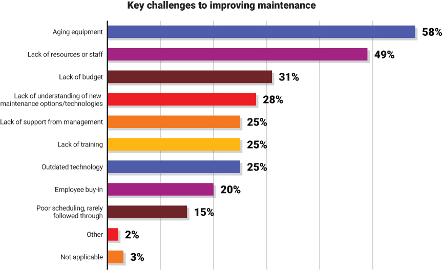

Key challenges to improving maintenance.

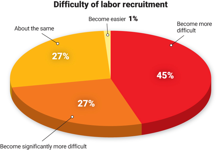

Difficulty of labor recruitment.

  • Ninety-seven percent of facilities experience challenges when improving maintenance. The top challenge remains aging equipment (58%), but a lack of resources or staff has increased from 37% in 2021 to 49%.
  • Following up to maintenance challenges, labor recruitment has become more difficult, or significantly more difficult, over the past 12 months, according to 72% of survey respondents.
