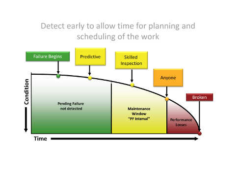

Operators are closest to the equipment and know when it’s running in a stable mode of operation. Besides on-line monitoring systems at their disposal, operators use their senses (i.e. sight, hearing, smell, touch) to detect abnormal signals usually associated with equipment in distress. The point of failure (PF) curve in Figure 4 shows how a symptom deteriorates over time, or cycles, and where operators can provide an additional line of detection should failure initiate between predictive maintenance (PdM) collection dates. The earlier the operator can sense these symptoms the more time the organization has to plan and execute a repair. In some instances, simple actions can resolve the cause of distress and the PF curve is extended. Operator inspections add a layer of protection against equipment failure and should be considered for every EMP.

Operator-led inspections are meant to identify the symptom of equipment failure with enough advance warning that a maintenance technician can effectively troubleshoot the problem and take appropriate action. The criteria on the inspection sheet, or procedure, helps the operator to identify failure modes early enough on a PF curve to allow successful troubleshooting, planning and scheduling corrective action before equipment failure impacts the value stream.
