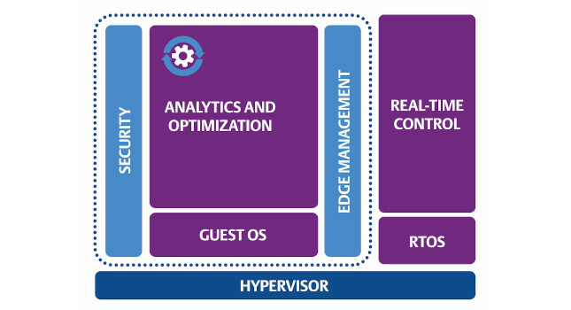

Today there are hardware advances common to the commercial PC world such as multicore processors and large memory. By using multicore technology and Type 1 virtualization, industrial controller platforms can now run multiple OSs on the same processor, including a RTOS for control which will experience little to no effect on the determinism and speed (Figure 1). A second Linux guest OS can be used for other edge processing. As the number of available cores increases in the future, even more OSs can be deployed.
For edge-located controllers, the possibility of running multiple OSs is a dramatic shift (Figure 2). The primary concern is maintaining a robust RTOS for control functionality, as with PLCs, so the automation functionality is not compromised. A secondary OS, operating as supplemental to the RTOS, provides additional computing options. The two OSs must be independent, but maintain the ability to interact.
The concept of running two OSs in an edge-located industrial controller can be further explained in terms of an “inner” and an “outer” loop, which may be familiar to users of cascaded process control loops (Figure 3). In this case, the inner loop is the RTOS VM for control, while the outer loop is a standard OS VM for added functions. For instance, the inner loop could monitor a process flow input, perform the proportional-integral-derivative (PID) calculations, and command the control valve output. The outer loop can advise the inner loop regarding the optimal flow rate, but it will not impact inner loop operation otherwise.
Another way of explaining the inner and outer loop concept is an analogy related to navigating a car. The inner loop is represented by the driver’s direct attention to drive the vehicle to its destination, while the outer loop could be the car’s dashboard navigation system providing supplementary information.
Therefore, the inner loop is mission critical and must always carry on operations without fail, even if the outer loop experiences a problem. On the other hand, the outer loop is valuable, but not essential, to basic system operation. The following sections explore this concept further.
