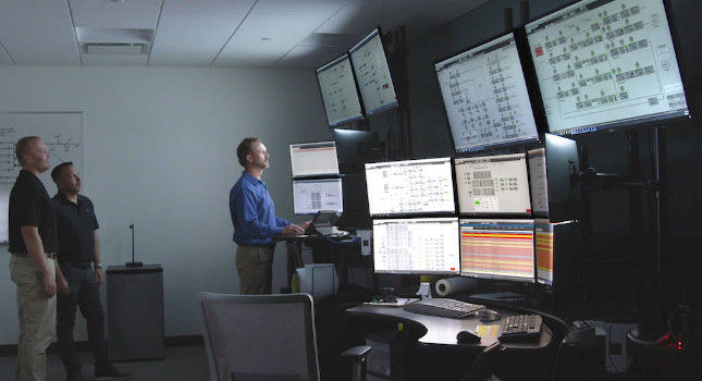

Figure 1: Open-standard and interoperable IIoT tools including message queuing telemetry transport (MQTT) and Sparkplug B can provide a non-proprietary, single source of truth for a data architecture system. Courtesy: Inductive Automation

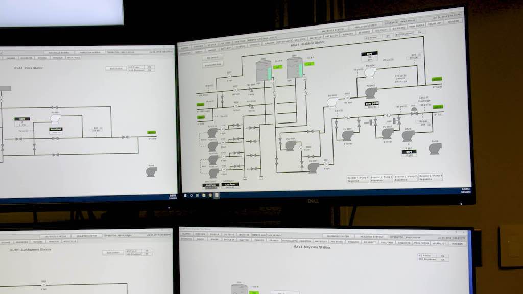

Figure 2: The right supervisory control and data acquisition (SCADA) or IIoT platform can connect assets from any number of sites to publish data from the edge. Courtesy: Inductive Automation

First, IIoT needs a platform, or a mechanism to connect to shop-floor systems. The right supervisory control and data acquisition (SCADA) or IIoT platform can connect assets from any number of sites, from the field, from anywhere OT assets live, to publish data from the edge. MQTT is a data-transfer protocol designed to push data from thousands of devices across numerous sites to industrial and business applications. Sparkplug B adds context to the data to extend use cases.

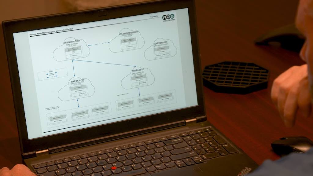

Figure 3: There is a constant need for better and consistent data flow in the control room so engineers can make better-informed decisions. Courtesy: Inductive Automation

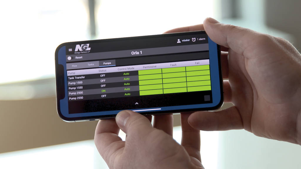

Figure 4: MQTT and Sparkplug B can help engineers have better data flow and operate a SCADA system from their phone. Courtesy: Inductive Automation
