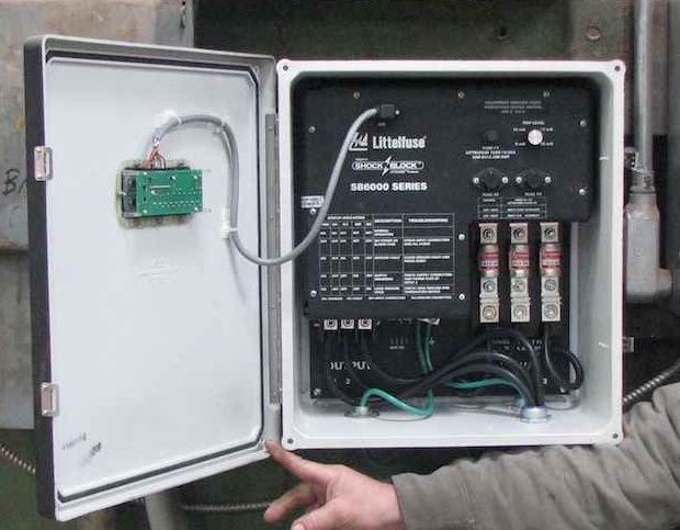

GFCIs for lower voltage applications (up to 240 V) have been on the market for a long time, but their use has not always been practical in industrial applications. GFCIs for higher voltage applications (480-600 V) did not exist until last year. Now that industrial GFCIs (See Figure 3) are available for equipment operating at this level of voltage, and are UL listed, the adoption of such protection is expected to grow.

Industrial GFCIs may be integrated by the equipment OEM or panel builder, or they may be installed in an electrical cabinet such as a motor control center. They are also available with their own enclosures, for mounting to the side of a machine or a wall.
The wiring is simple: attach source power on one side and the load on the other side (See Figure 4). No wiring to a circuit breaker is required because the GFCI internal interrupting mechanism can interrupt power on its own. In addition, there may be signal wiring for optional alarm communication.
Some models are equipped with built-in overcurrent protection (fuse), which allows for a high interrupting rating (50 kA in some cases). This protects the internal contactor from damage and doesn’t require the user to install a current limiting device upstream of the industrial GFCI. Some models also offer undervoltage, brownout, and chatter detection.
