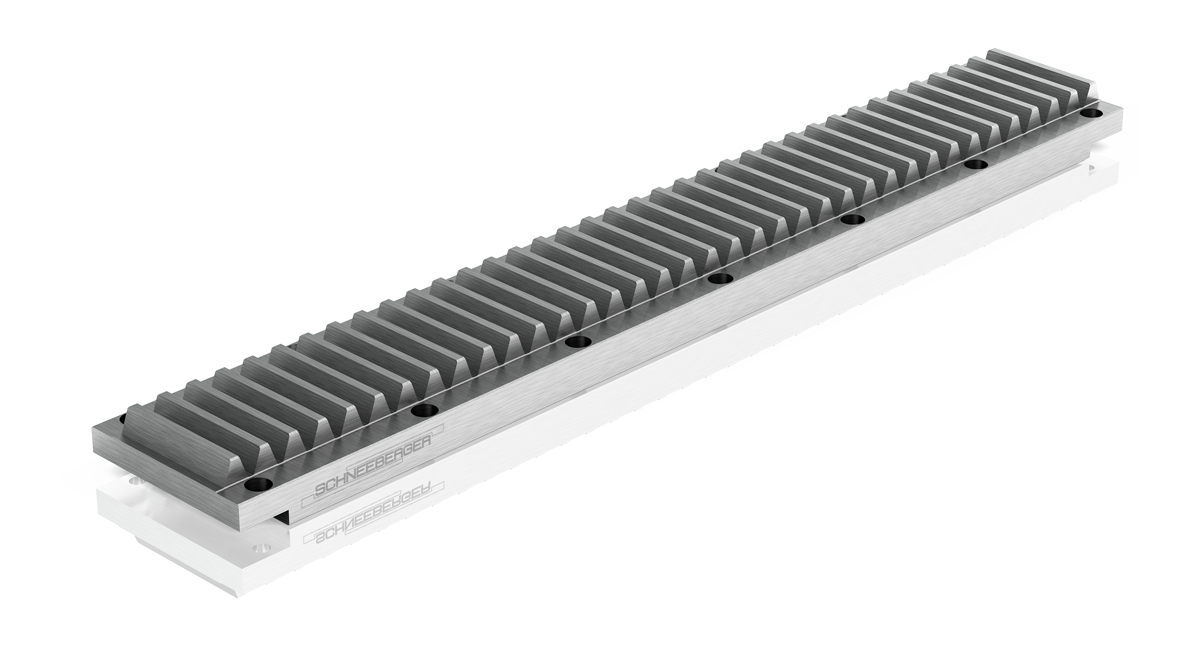

Standard straight tooth gear rack. Courtesy of: Schneeberger Inc.
Gear racks with a Q4 rating have an individual adjacent pitch error of 3 µm and a cumulative pitch error of 15 µm per 1000 mm. The maximum single piece length is 3 meters. Connection with the rail’s butt joints permits longer ranges of travel.
Note that according to German standards, there are 12 gear qualities that can be achieved with different manufacturing methods, where 1 (Q1) is the finest and 12 (Q12 is the coarsest gear quality. A typical grade for precise machine tools is Q6.

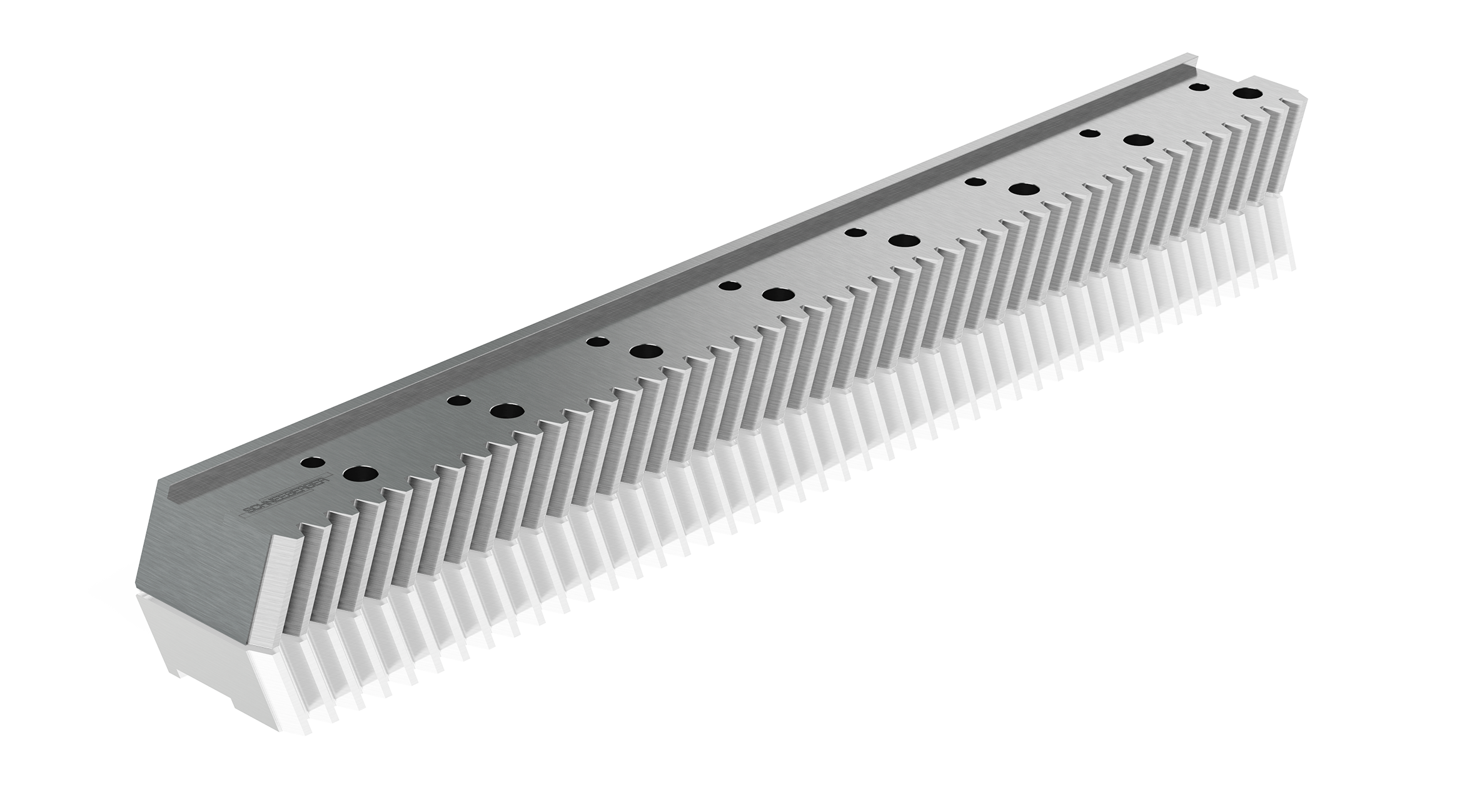

A helical tooth gear rack. Courtesy of: Schneeberger Inc.
Customized gear racks can be produced in dimensions up to module 20 and in lengths up to 3 meters. The design engineer can choose from different materials, hardness levels and fastening options (i.e., lateral, vertical, dead-end and flange type).

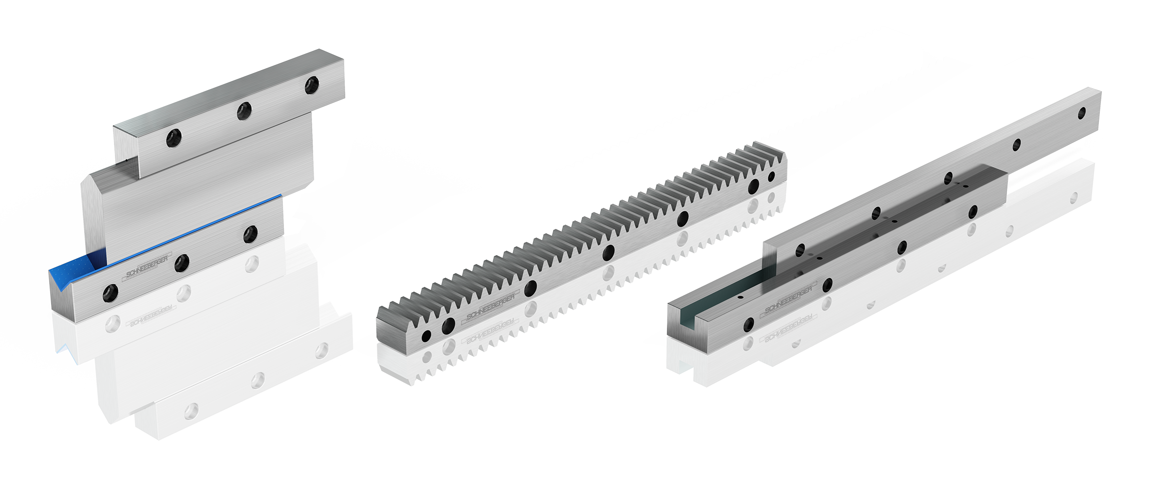

Custom gear racks. Courtesy of: Schneeberger Inc.
Synchronized gear racks (gantry machines) are also available. These devices consist of two rows of racks that are ground together in parallel. The tolerance between the two racks is 1 to 2 microns -providing smooth motion and movement.

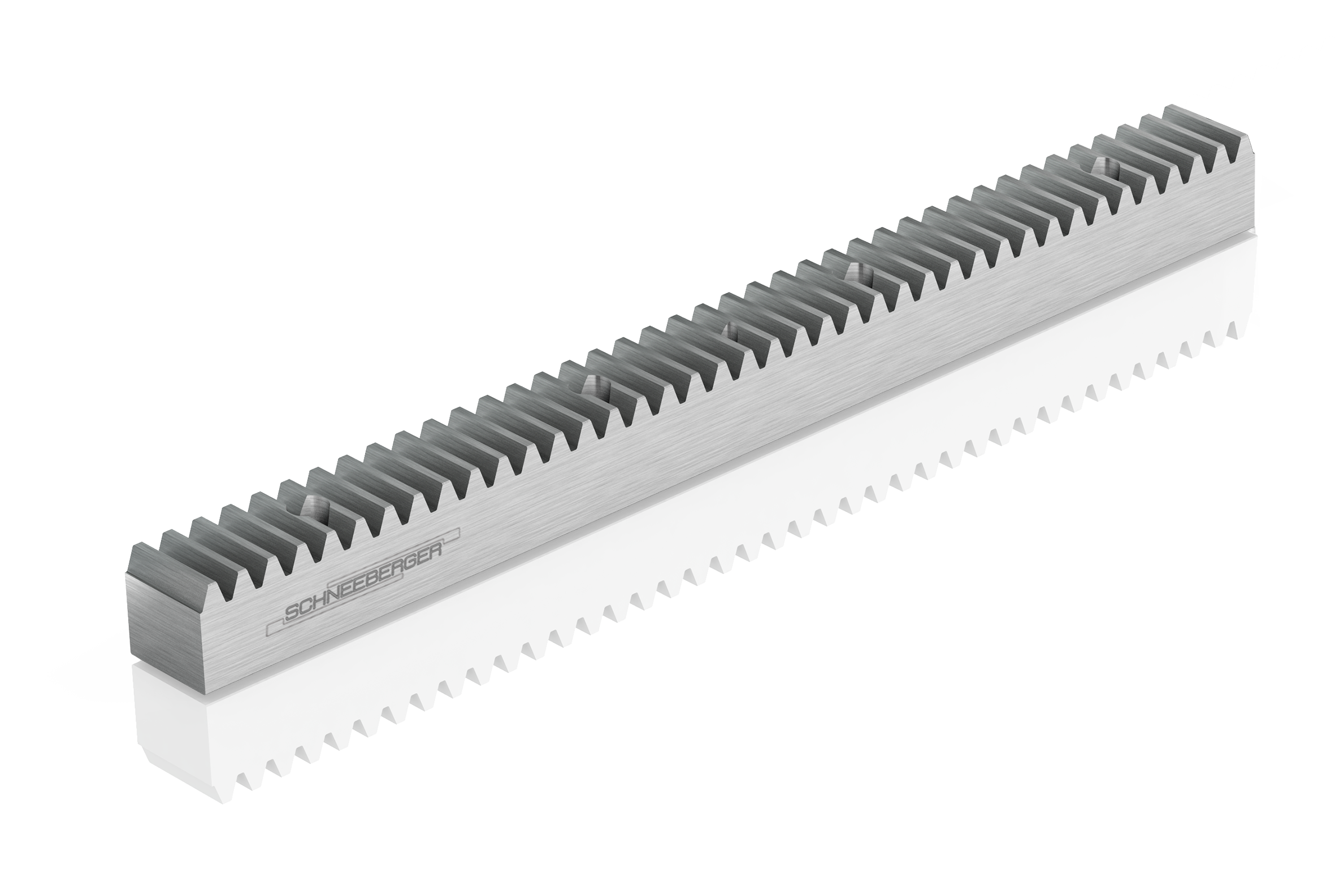

This custom gear rack is available up to 3000 mm in a single piece. Courtesy of: Schneeberger Inc.
