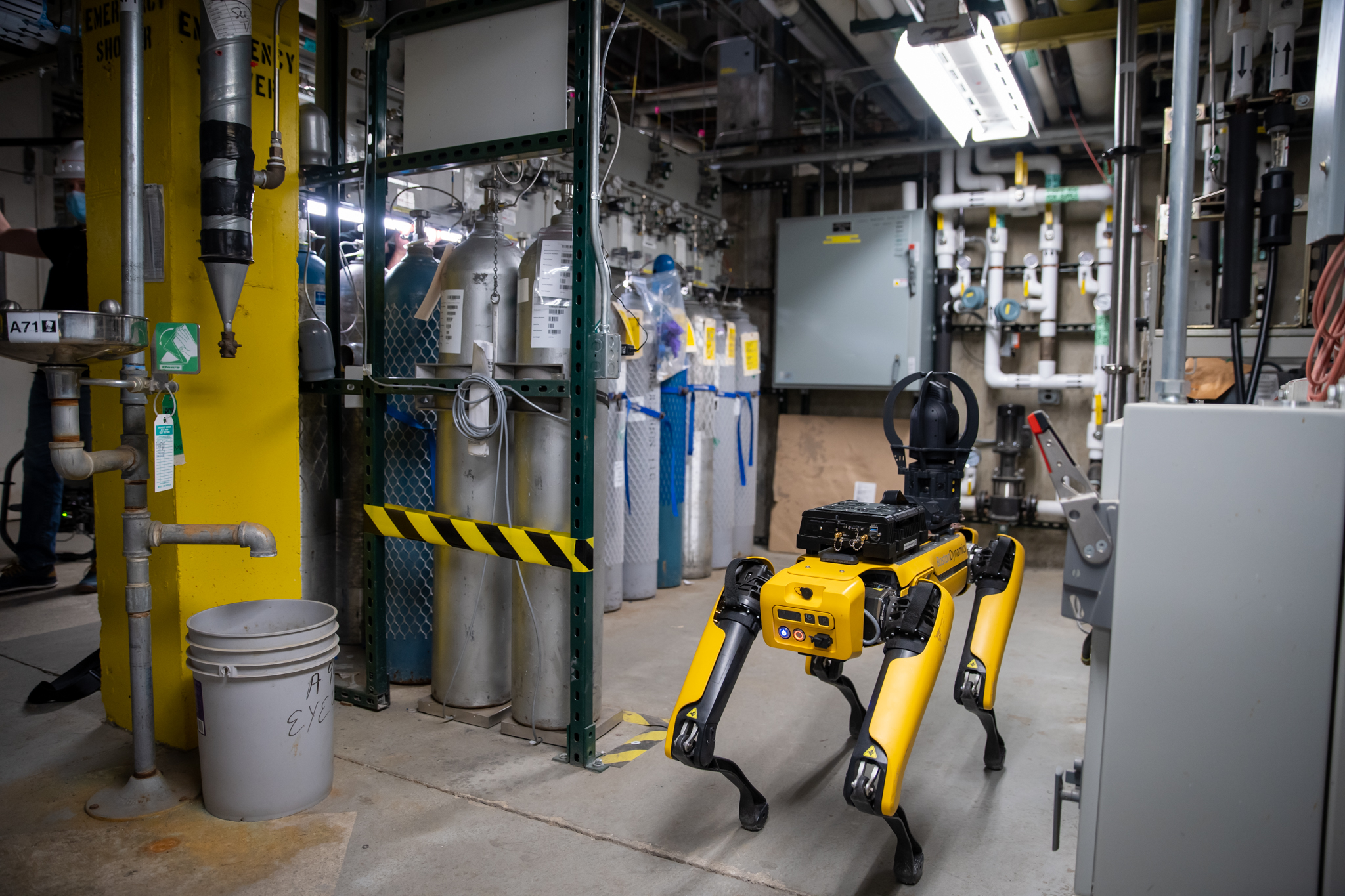

GF started rolling out an entirely new form of automation — mobile robots — to support the operational efficiency of its production facility, which manufactures semiconductors used in communication devices, radio frequency technology and more. A team oversees the deployment of automated material handling and robotic solutions, including Boston Dynamics’ Spot, an agile mobile robot that traverses rough terrain, climbs stairs and autonomously navigates the 209,000-square-foot facility.
Figure 1: Spot, which is a robot outfitted with a Spot CAM + IR (an integrated radiometric thermal camera) payload, at GlobalFoundries' Essex Junction, Vermont, facility. Courtesy: Boston Dynamics
Figure 1: Spot, which is a robot outfitted with a Spot CAM + IR (an integrated radiometric thermal camera) payload, at GlobalFoundries’ Essex Junction, Vermont, facility. Courtesy: Boston Dynamics

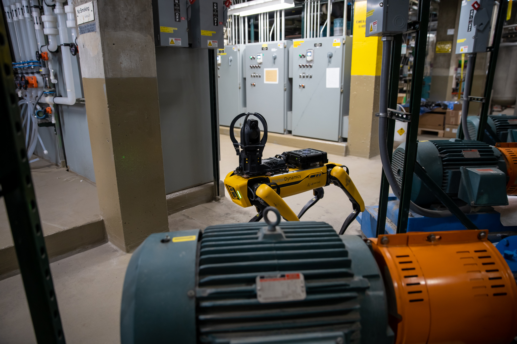

Spot is now regularly helping and systematically collecting valuable data about the thermal conditions of the equipment. The robot takes the exact same images from the exact same angle at the exact same times and its work is creating entirely new, critical data streams for the team. The challenge then becomes how best to use the information.
Figure 2: The robot Spot collects valuable data about the thermal conditions of equipment at GlobalFoundries' facility. Courtesy: Boston Dynamics
Figure 2: The robot Spot collects valuable data about the thermal conditions of equipment at GlobalFoundries’ facility. Courtesy: Boston Dynamics
Making this data actionable required integrating it with an existing system, which aggregates data from equipment, including fixed sensors and now data collected by Spot. The team has one place to see all the signals from the equipment, providing a holistic view of operations. Because most of the equipment has a long life cycle and slow rate of change, it does not require a continuous data stream, but with periodic inspections by Spot, the team can better monitor these assets over time, resulting in more informed decisions to keep the facility running efficiently.
