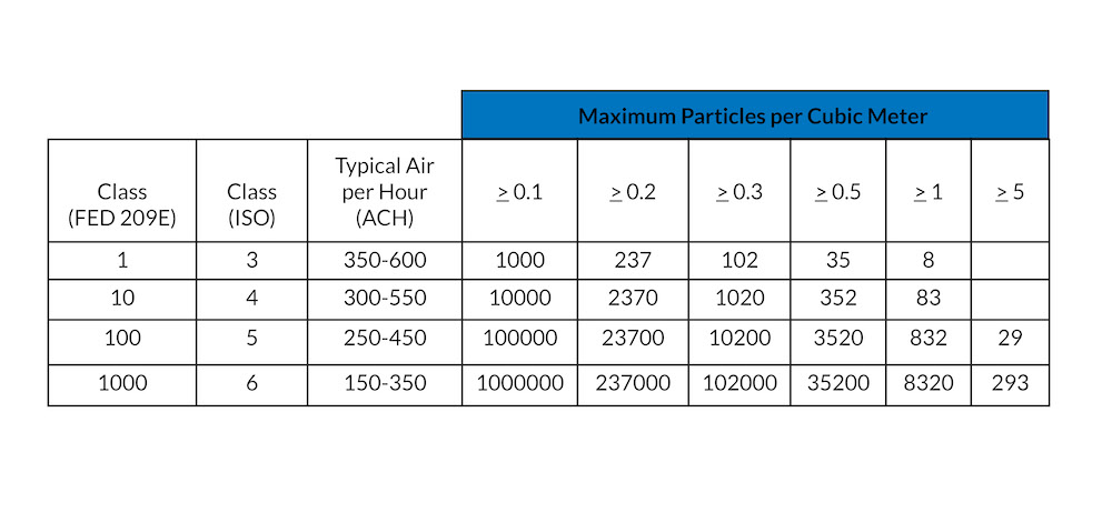

Particle counts and air changes per hour typical of semiconductor manufacturing cleanrooms. Data from ISO 14644-1:2015. Courtesy: NorthWest Engineering Service, Inc. (NWESI)
Anyone who has seen photos of semiconductor factories immediately thinks of cleanrooms, with people in white gowns, hoods, and gloves.  Semiconductor manufacturing often requires Class 1, 10 or 100 levels of filtration, the requirements for which are shown in Table 1. This is attained with expensive filters and large quantities of air circulation, thus requiring a measured and balanced ventilation system.

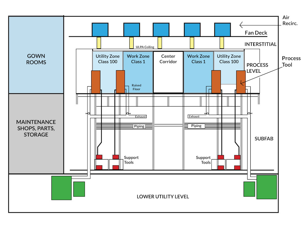

Cleanrooms take up very little space in the sprawling campuses typical of semiconductor factories.  Most of the work done by specialized personnel takes place in the levels above and below the cleanroom floor where the process tools are located, as shown in Figure 1.  For the TAB professional, the most vital work takes place in areas commonly termed the interstitial (one level above the cleanroom) and subfab (one level below the cleanroom).  In particular, the level below the cleanroom (or in some factories, between cleanrooms) is the most challenging.  This is where all the equipment required to operate the tool is placed, consisting of a multitude of cabinets and utilities delivering electricity, gases, and liquids to the cleanroom.  The TAB professional’s job is primarily to balance several types of the tool’s exhaust products, some with chemicals that are hazardous to human health.  Safety issues also arise because the ductwork typically requires ladders and harnesses, climbing in and around dozens of other wires, ducts, and tubes to get to the dampers and valves.
In the large factories typical of production scale fabrication, there may be dozens of tools connected to the same exhaust lines and each finely balanced on a system constantly running at maximum capacity to feed all the tools on the line.
Figure 1: Representation of multiple utility zones used to support semiconductor manufacturing. Courtesy: NorthWest Engineering Service, Inc. (NWESI)
