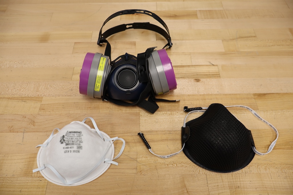

Air-purifying respirators are self-contained devices that remove contaminants from the air to make it safe to breathe. Different kinds can remove particulates, vapors or both. They are all classified as negative pressure devices, so they may not be suitable for use by someone with medical conditions as noted above.
Particulate respirators capture airborne particles in small spaces between the fibers that make up their construction. These include simple masks that cover the mouth and nose and are typically considered disposable. They also come in a rigid frame with replaceable filter elements. As particulate accumulates in the fiber, these become more effective after some use but take care to replace them when any resistance or breathing difficulty is noted.
Figure 1: Here are three examples of air purifying respirators. Top: High-efficiency P100 cartridge-type respirator for organic vapors, chlorine, hydrogen chloride, sulfur dioxide or chlorine dioxide. This respirator can also be used for hydrogen sulfide but only in an emergency to escape from the contaminated area. Bottom: Two particulate mask-type respirators for general purpose use. Courtesy: Exair
Vapor respirators use chemical filters (usually in a cartridge or canister) which absorb the vapor. There are different specific types for different vapors; NIOSH has a color-coding system for them:
    • Black: Organic vapors
    • Bright green: Ammonia
    • White: Acid gases
    • Yellow: Organic vapors and acid gases
    • Olive/brown: Organic vapors, ammonia, acid gases
    • Magenta: High-efficiency filter, P100 filters
    • Black, magenta: Organic vapors and high-efficiency filter, P100 filters
    • Yellow, magenta: Organic vapors, acid gases and high-efficiency filter, P100 filters
    • Olive/brown, magenta: Organic vapors, ammonia acid gases and high-efficiency filter, P100 filters
Combination respirators have both particulate and vapor filters. These are especially popular when working with pesticides, as well as other chemical or biological agents that create airborne particulate and vapor contaminants.
