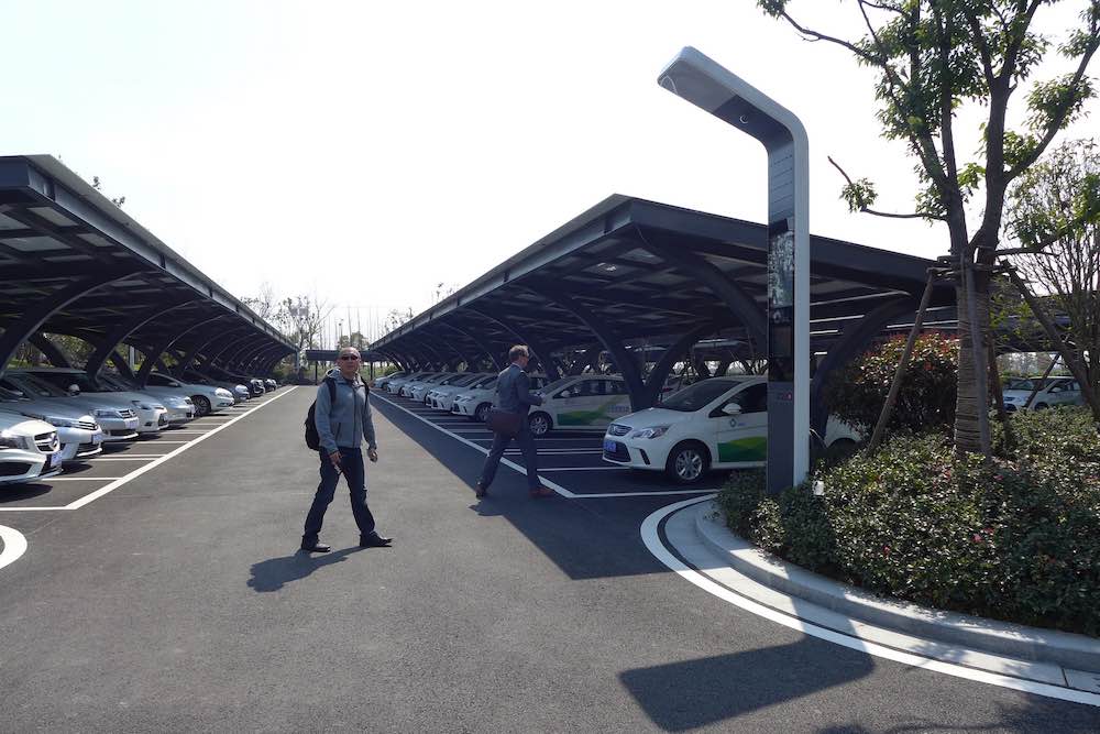

Figure 1: Example of a stranded asset parking lot that was converted into a solar energy facility in Shanghai. Courtesy: Hedgehog Technologies
1. Transforming stranded assets into renewable energy generators
Stranded assets such as parking lots and rooftops can be converted into valuable energy-producing areas by installing solar photovoltaic panels. These solar panels have the capacity to generate megawatts of electricity on-site, reducing the need to purchase energy from the grid — particularly during peak daylight hours when energy prices may be higher. Recently, Six Flags Magic Mountain initiated a groundbreaking 12.37-megawatt solar carport, described as California’s largest solar energy project.

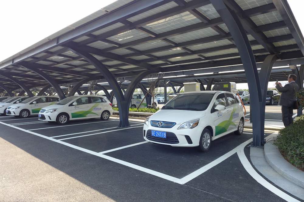

Figure 2: Example of a stranded asset parking lot that was converted into a solar energy facility in Shanghai. Courtesy: Hedgehog Technologies

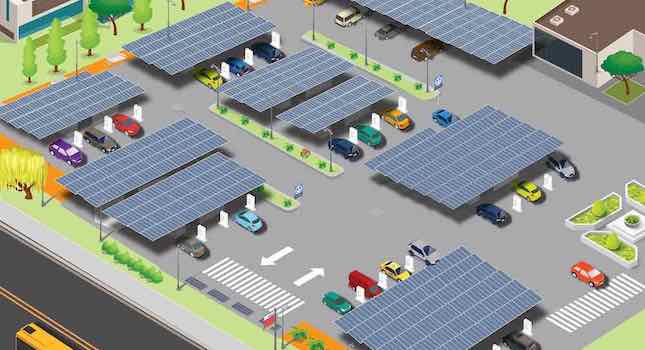

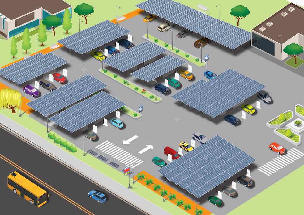

Figure 3: Graphic recreation of a stranded asset being repurposed for solar energy generation. Courtesy: Hedgehog Technologies
