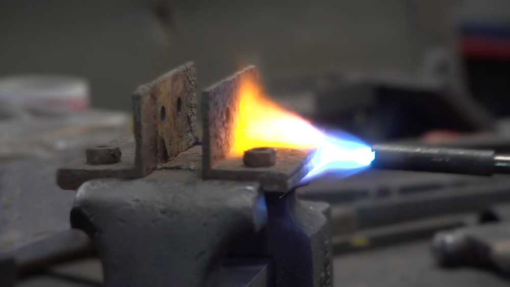

A common technique used when attempting to salvage a part is to apply heat. The heat source may come in the form of a propane torch, acetylene torch, heat gun, induction heat or a heated element (see Figure 1). So how does it work?
Figure 1: A common technique used when attempting to free a stuck part is to apply heat. The process involves many risks and requires great skill.
Figure 1: A common technique used when attempting to free a stuck part is to apply heat. The process involves many risks and requires great skill. Courtesy: Kano Laboratories
“Scientifically, heat expands metals, and two different sizes or types of metals such as a nut and a bolt will expand at different rates. This can help break the bonds of rust,” said Sevan Demirdogen, CEO of Kano Laboratories, producer of Kroil Penetrants. “As metal cools, it contracts at different rates, and continues to separate seized parts. However, using heat to remove frozen or seized components can be tricky and risky. As such, heat should only be applied in special circumstances by highly experienced workers, using proper equipment in a controlled environment.”
While using heat can be effective, there are many risks, and executing this process requires great skill. Without the proper technique, many challenges can result, including:
  • Fire/burn risk. When working with heat or an open flame, workers run the risk of burning themselves, someone else or adjacent materials. Working near flammable materials and/or chemicals is even more dangerous.
  • Accessibility. Not everything you want to take apart is at ground level or on a work bench. Many times, equipment is either high above ground, underground or in tight spaces. In these instances, heat-generating equipment or open flames may be nearly impossible to apply properly and safely.
  • Mobility. It’s not easy to carry heat generating equipment along with all the tools required for a given job; this can be especially cumbersome when multiple locations are involved.
  • Dangerous gasses. Using an open flame in an unventilated, confined space can create a dangerous atmosphere due to toxic gasses, carbon monoxide and/or oxygen depletion.
  • Damaged or destroyed metal. If one overheats metal to a molten glow, they can damage or destroy the nut, bolt and any other adjacent parts. In cases involving hardened steel, applying heat can actually break down the hardening properties.
