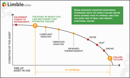

For example, consider the example of preventive maintenance (PM) of an internal combustion engine shown in Figure 1. Instead of replacing engine oil and filters at every given interval as part of regular maintenance, additional tests on dissolved gasses, lubricant analysis and vibration analysis can be performed, providing greater insight on the root causes of a wide variety of potential failure in the engines. Such advanced testing procedures can be employed to detect the presence of incipient failures that may turn into a catastrophe for the entire operation if left unattended.
Figure 1: P-F interval represents the time interval between two states of the same asset.
Figure 1: P-F interval represents the time interval between two states of the same asset. Courtesy: Limble CMMS
