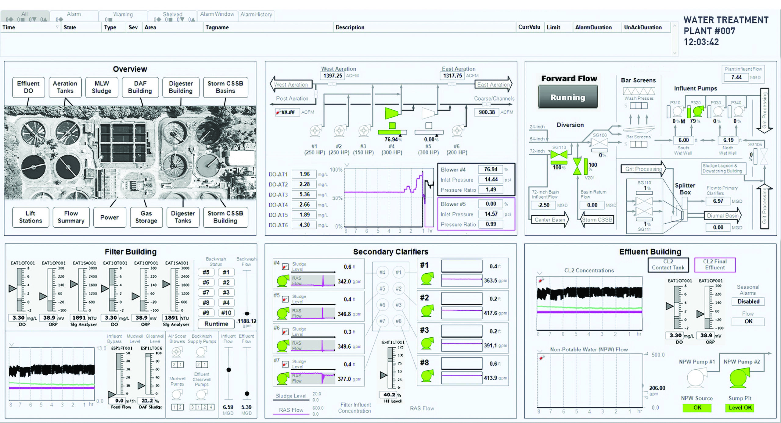

Figure 1: Not only can OPC UA be used to relay the real-time values like sensor readings to SCADA HMI screens across vendors; it can also relay alarm conditions that SCADA builds on top of thosevariables, so that dangerous or costly deviations can be quickly identified and addressed. Third-party reporting software streamlines operational and compliance reporting from data sources like SCADA, HMI and historians. Courtesy: SmartSights
Figure 1: Not only can OPC UA be used to relay the real-time values like sensor readings to SCADA HMI screens across vendors; it can also relay alarm conditions that SCADA builds on top of those variables, so that dangerous or costly deviations can be quickly identified and addressed. Third-party reporting software streamlines operational and compliance reporting from data sources like SCADA, HMI and historians. Courtesy: SmartSights

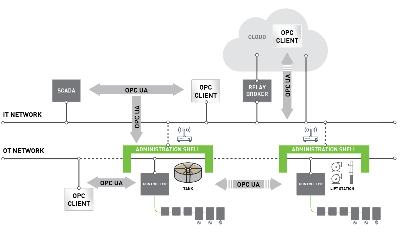

Figure 2: OPC UA helps water utilities meet the challenge of secured exchange of structured data between devices, equipment and services. OPC UA is also designed to share that data upwards from the OT network to IT networks and to the cloud beyond. Courtesy: SmartSights
