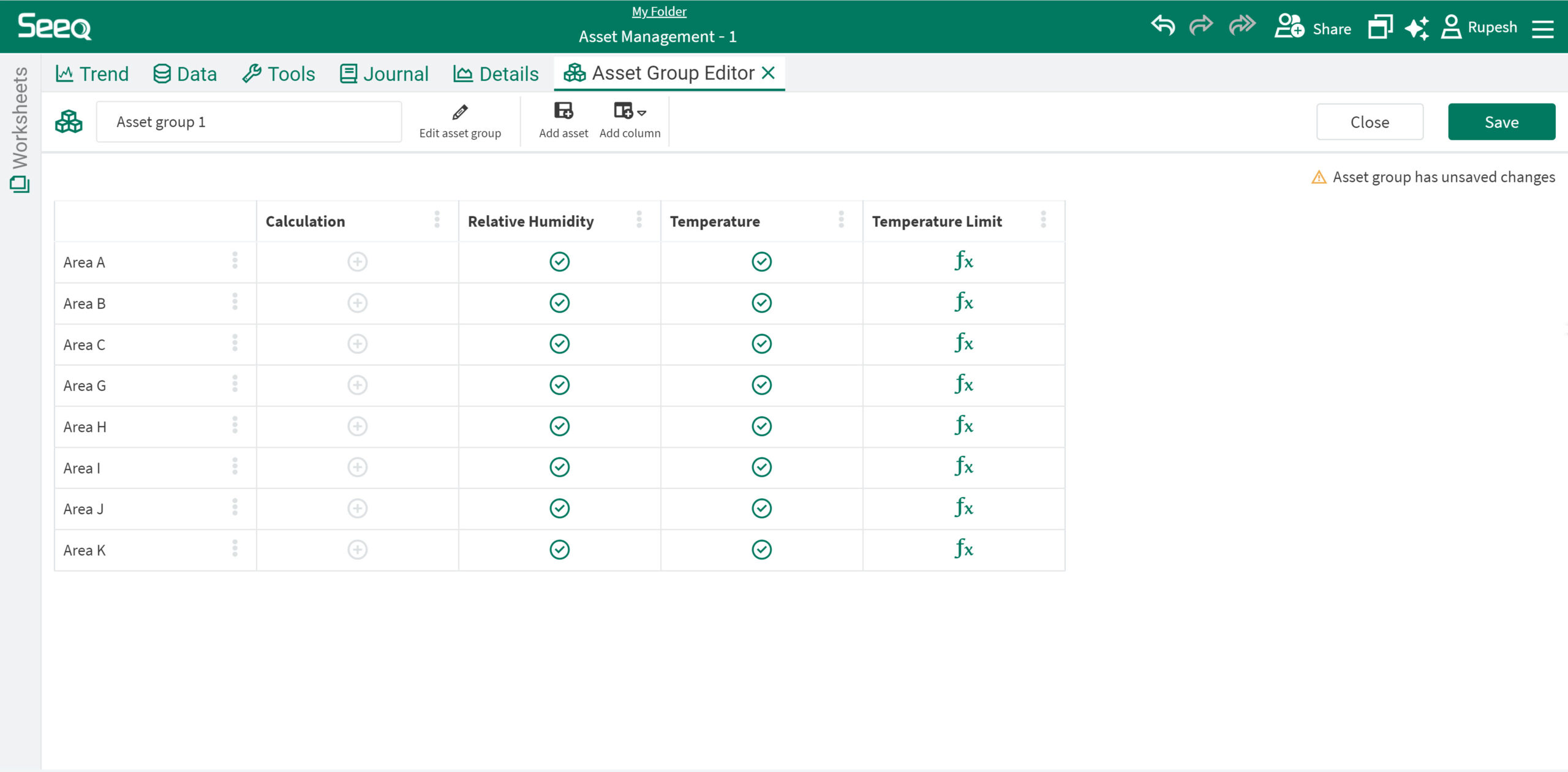

Figure 1: Seeq’s Asset Group Editor provides an intuitive interface for organizing and adding calculations in analyses. Courtesy: Seeq

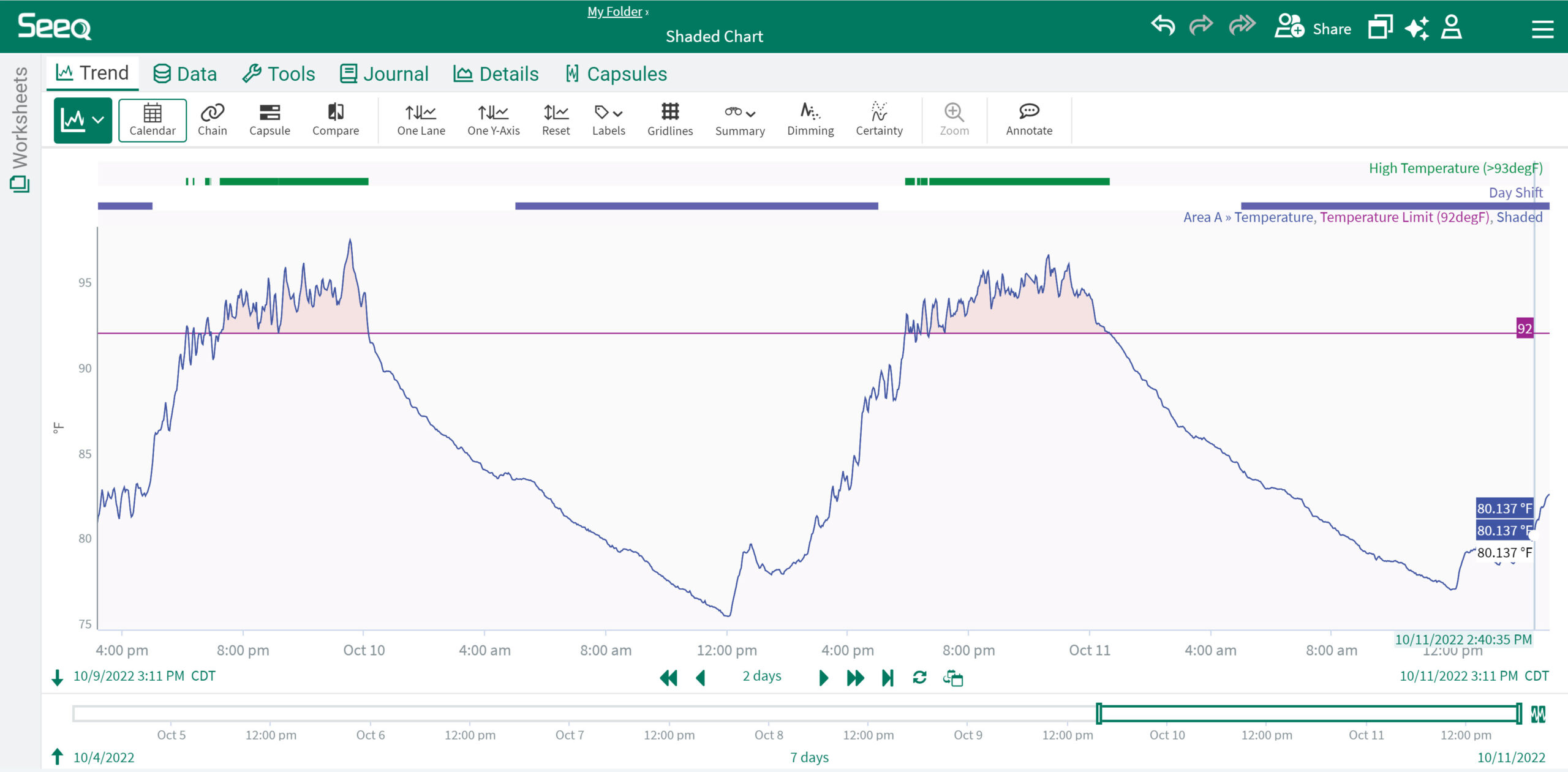

Figure 2: Seeq enables superimposing process data and customized calculations to help plant personnel derive a holistic picture of plant performance with context. Courtesy: Seeq

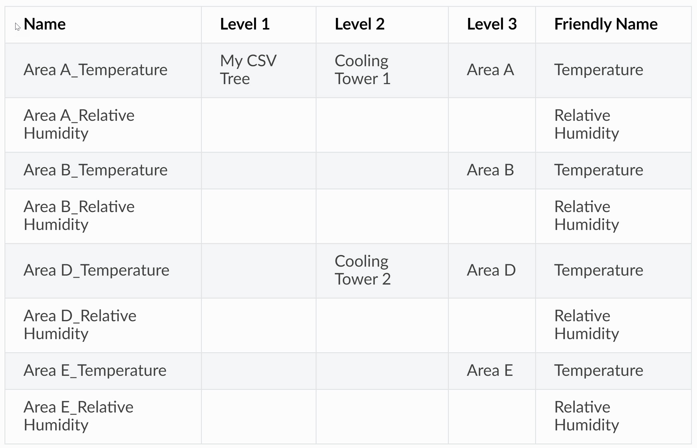

Figure 3: With just a few lines of Python code, subject matter experts can build out massive asset structures within Seeq, based on entry in a CSV or other spreadsheet-based text file. Courtesy: Seeq
Template files (CSV): For use cases that are too large to manage efficiently with point-and-click tools, using a spreadsheet program to create asset structures can be beneficial. With a few lines of Python code, advanced analytics platforms can ingest a spreadsheet-based text file — such as a CSV — and build the asset structure within the platform.
This approach provides significant benefits for iteration at scale, enabling manufacturers to quickly build large asset structures, deploy them, evaluate their effectiveness and make necessary adjustments (see Figure 3).

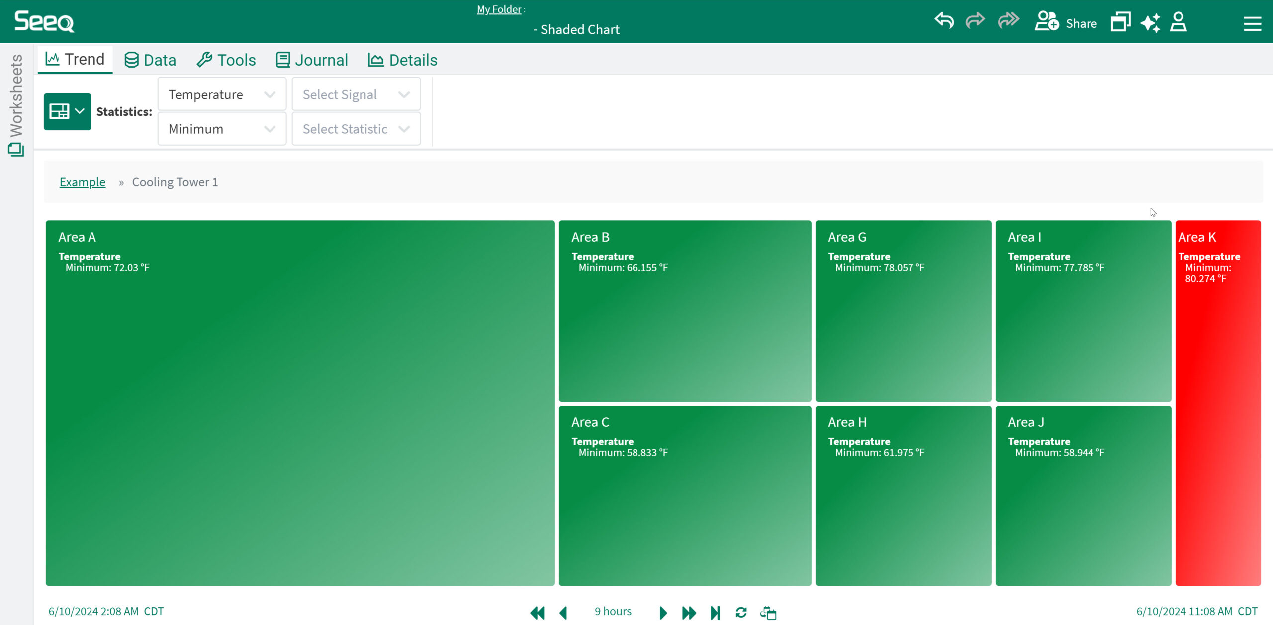

Figure 4: Dashboards provide at-a-glance asset health monitoring, fostering informed operations and maintenance decision-making. Courtesy: Seeq
By prioritizing ease of use and scalability, AI-equipped advanced analytics platforms empower organizations to leverage their data effectively, driving smarter decision-making and maximizing process efficiency.
