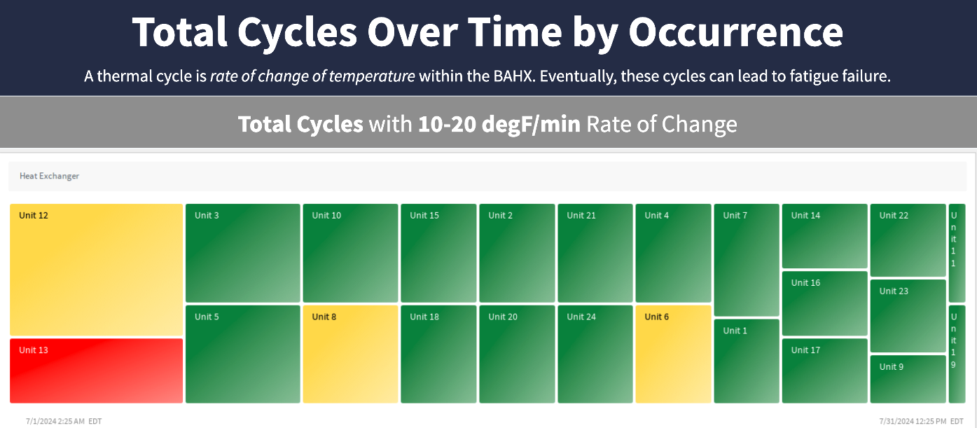

Phillips 66, a large multinational energy company, used Seeq — an industrial analytics, AI and monitoring platform — to develop a monitoring tool for its fleet of brazed aluminum heat exchangers (BAHX). A catastrophic failure occurred in 2016 at another company in the same industry and the U.S. Chemical Safety Board subsequently issued BAHX operating best practices to prevent the future occurrence of similar safety and environmental incidents.
Adhering to these recommended industry standards required monitoring the number of cycles and temperature differential within each heat exchanger, to notify operations staff when limits were exceeded, prompting appropriate action.
By leveraging the thermocouple data from the inlet and outlet of the hot and cold flow streams of each heat exchanger, the approach temperatures and running cycle count were calculated over six years of data for more than 100 heat exchangers. The calculation also accounted for the temperature differential severity because the likelihood of thermal cyclic fatigue at a brazed aluminum joint increases with higher temperature gradient, which can lead to failure.
Figure 1: A tree map image in Seeq highlights the plants with high cycle counts in the last month, one of many views in Phillips 66’s dashboard that highlights equipment requiring operational changes or inspection. Courtesy: Seeq
After creating the initial analysis, the team was able to scale the calculations across a custom asset hierarchy to proactively monitor more than 100 BAHX using a dashboard (see Figure 1). Every day, the reliability team receives an asset health report and they can take preventive measures operationally or mechanically to preemptively mitigate the risk of catastrophic failure.

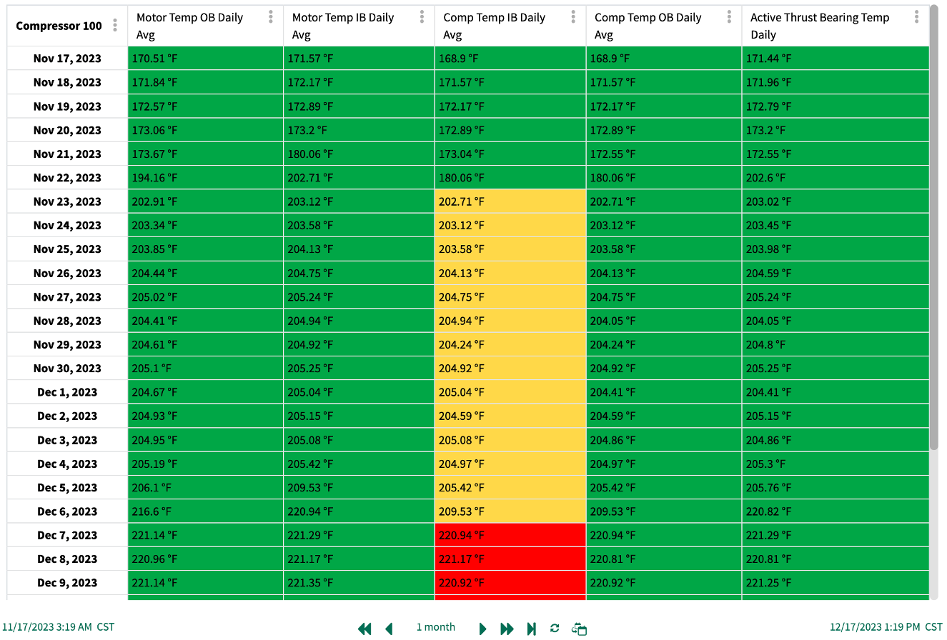

Saudi Arabian Oil Co. (Saudi Aramco), one of the world’s largest integrated energy and chemicals companies, used the same advanced analytics platform to predict centrifugal gas compressor failures. Historically, the company monitored temperature and vibration excursions solely in its alarm management system.
However, the team needed a predictive tool to track gradual deviations in compressor sensor data to avoid system trips, rather than the reactive approach of relying on its alarm system.

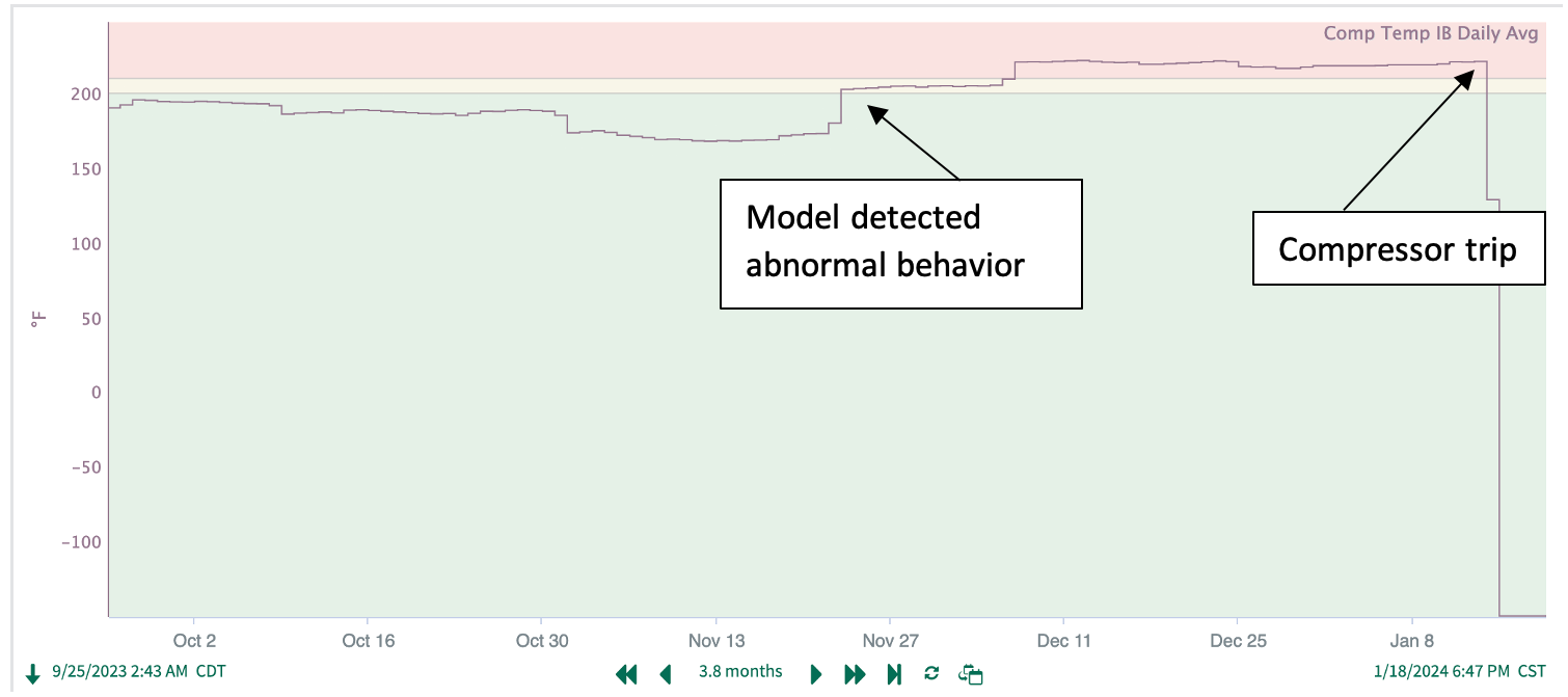

The predictive models that were developed monitored temperature and vibration to identify abnormal behavior, deviations and aggressive oscillations. First, the signals were cleansed for high-frequency noise, outliers and periods of bad data. Next, baseline behavior was determined by finding a dynamic threshold based on yearly averages with a margin of error. Then, daily average values were compared to the rolling yearly average to identify anomalies and the system generated alarms when abnormal conditions were detected.
This strategy was deployed on a fleet of compressors with more than 600 sensors to give the user enough time to investigate temperature and pressure excursions before a compressor trip. Then, the appropriate actions could be taken by operations and maintenance teams to avoid the trip altogether. The model was validated using historical trip event data to determine whether the exceedances would have been flagged with enough time before the trip and in several cases, anomalies would have been identified a full month before (see Figure 2).
Figure 2: Table view in Seeq of a historical compressor trip event used to validate Saudi Aramco’s predictive model. The model would have predicted an anomaly over a month before this trip occurred. Courtesy: Seeq

Figure 2: Trend view in Seeq of a historical compressor trip event used to validate Saudi Aramco’s predictive model. The model would have predicted an anomaly over a month before this trip occurred. Courtesy: Seeq
By implementing this tool, the company has saved hundreds of thousands of dollars on reactive maintenance and downtime losses, decreased flaring events and improved the reliability of its compressor fleet. The team monitors all 600 sensors to identify compressor anomalies and predict potential failures.
