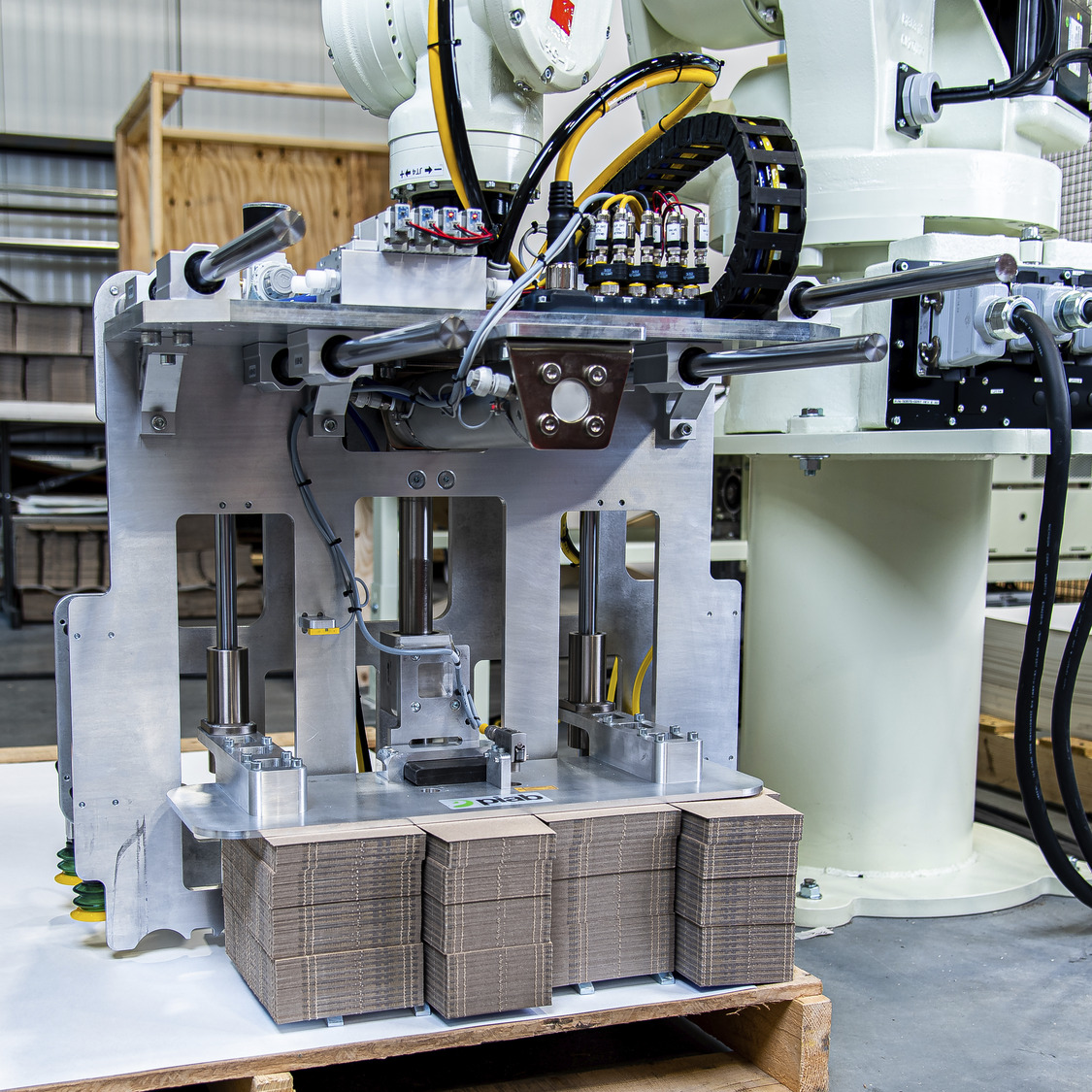

Figure 1: To ensure operator safety, the ACS team designed physical and programmable mechanisms, with the robot operating in a three-sided fenced area that runs only when gates are securely closed. Courtesy: ACS

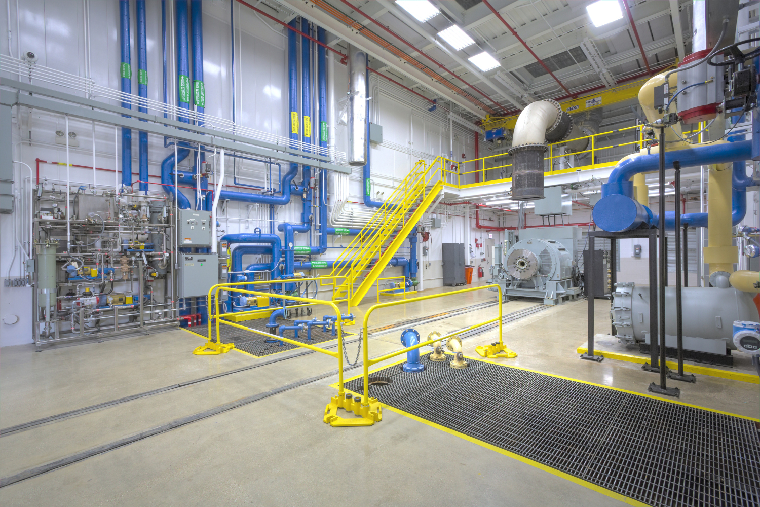

Figure 4: Designing R&D testing facilities "from the inside out" prioritizes testing criteria and capabilities, ensuring that facility integration and design align with testing requirements and product goals. Courtesy: ACS
Figure 4: Designing R&D testing facilities “from the inside out” prioritizes testing criteria and capabilities, ensuring that facility integration and design align with testing requirements and product goals. Courtesy: ACS
