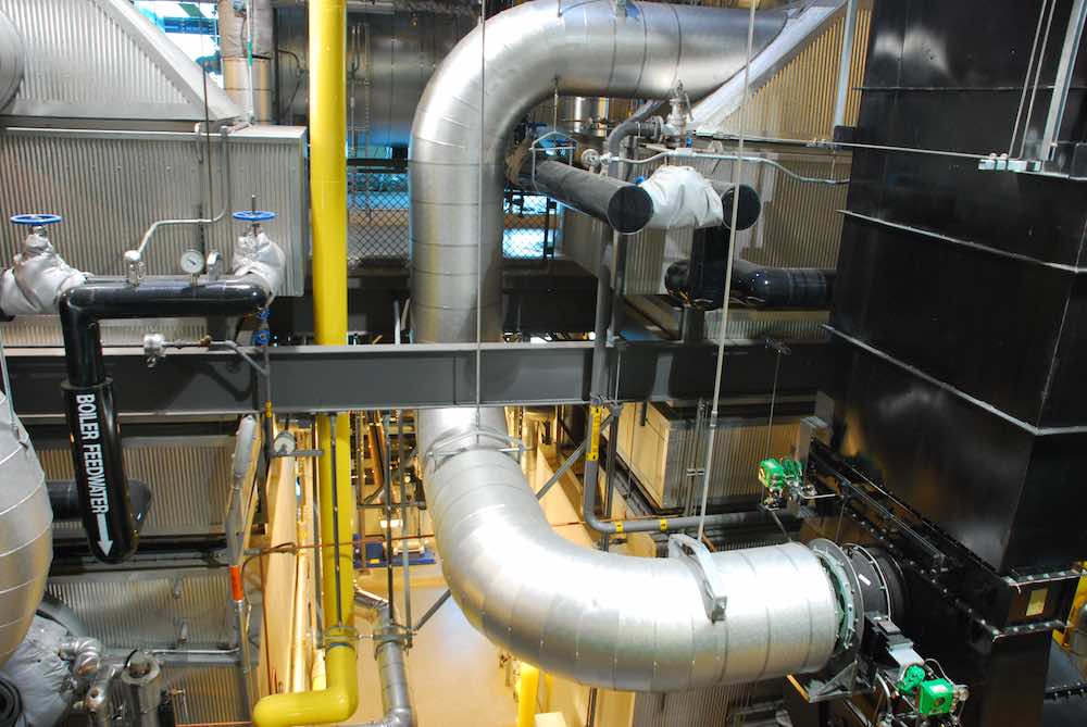

Hydrogen boilers are typically found in refineries, chemical plants and other facilities where hydrogen is produced in abundance as a byproduct of other processes. Refineries have learned to harness hydrogen in their boilers safely and efficiently. As their supply hydrogen is free, it helps these facilities save on fuel costs. Unfortunately, most facilities are not in their position. They will have to pay for hydrogen and it generally doesn’t come cheap.
Figure 1: Refineries have been operating on hydrogen blends for decades. And now power plants are beginning to blend it with natural gas. Courtesy: Rentech Boiler Systems

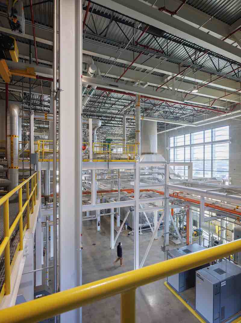

Figure 2: Some facilities are introducing hydrogen into the fuel mix to lower their carbon footprint. Courtesy: Rentech Boiler Systems

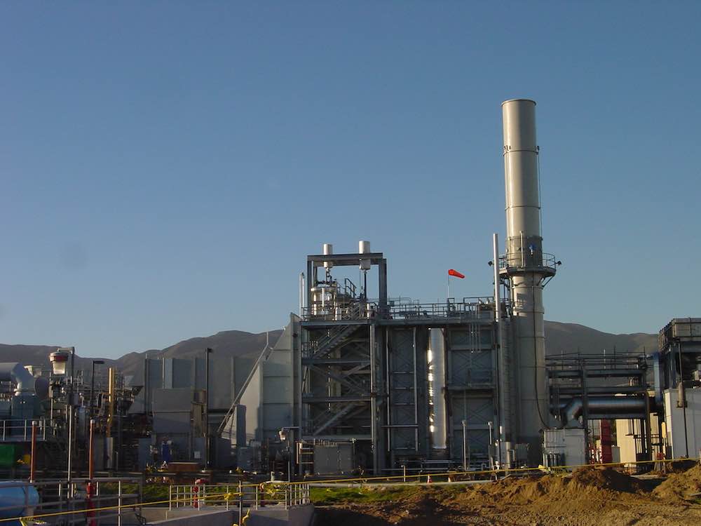

Figure 3: When hydrogen is introduced into industrial boilers, certain modifications may need to be made. Courtesy: Rentech Boiler Systems
