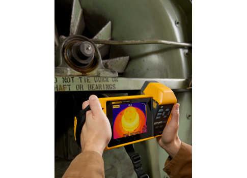

Thermal imaging at a substation
One example was recently seen at an electrical substation, which has many complex electrical systems and equipment that handle very high voltage current. To help ensure safe and consistent performance, more utilities are using infrared cameras to run proactive maintenance inspections on equipment ranging from oil-filled transformers to lightning arrestors to high-voltage transmission lines coming in and out of the substation.
A thermographer scanned the substation with an infrared camera and discovered the knife switches showed abnormal temperature. Because there appeared to be high resistance a short distance from the switch, that overheating could have led to a failure. Finding this situation in a routine inspection could potentially save the utility company and its customers a major power outage. Without the inspection, a switch knife failure could have occurred and caused unplanned downtime. This would have directly impacted the availability of equipment, thus the OEE matrix.
