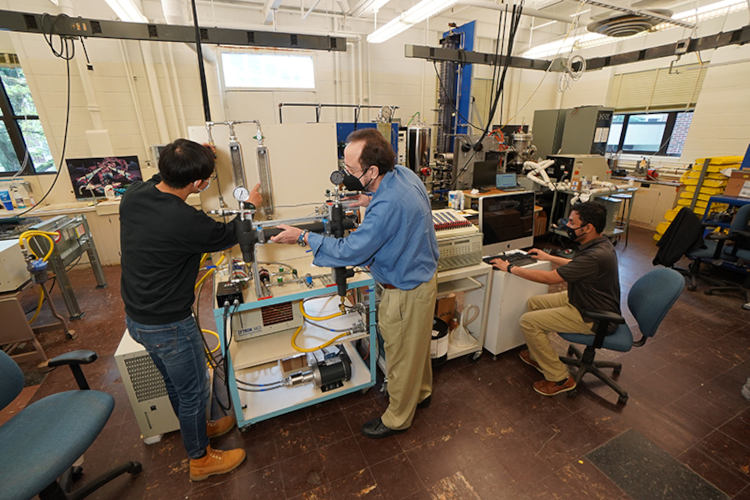

A new charging cable design developed by Purdue professor Issam Mudawar (center) and his students could reduce an electric vehicle’s charging time to under five minutes.
A new charging cable design developed by Purdue professor Issam Mudawar (center) and his students could reduce an electric vehicle’s charging time to under five minutes. Courtesy: Purdue University and Jared Pike.

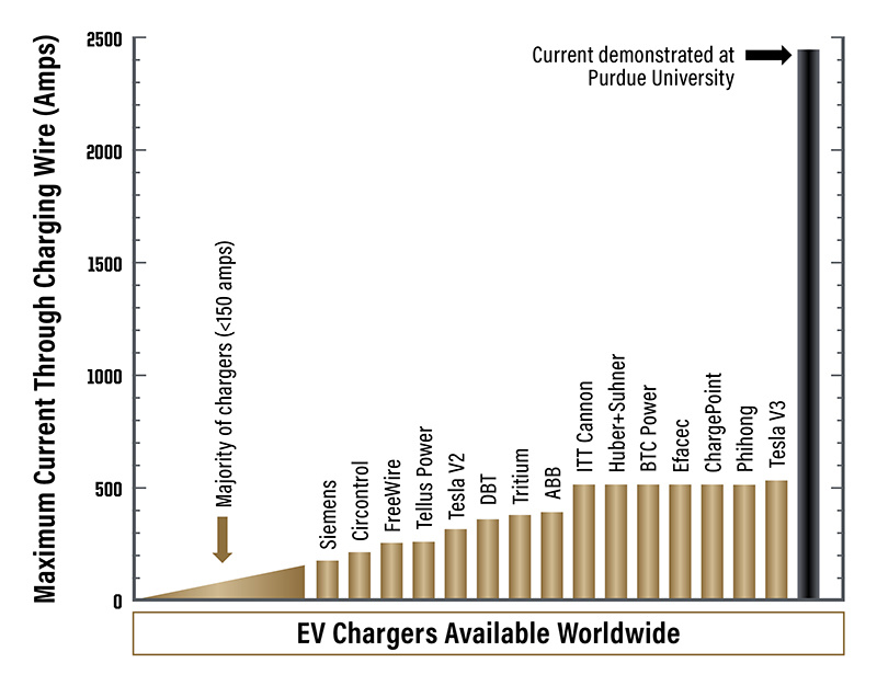

Though the prototype hasn’t been tested on EVs yet, Mudawar and his students demonstrated in the lab their prototype accommodates a current of over 2,400 amperes – far beyond the 1,400-ampere minimum that would be needed to reduce charging times for large commercial EVs to five minutes. The most advanced chargers in the industry deliver only currents up to 520 amperes, and most chargers available to consumers support currents of less than 150 amperes.

The prototype also mimics all the traits of a real-world charging station: It includes a pump, a tube with the same diameter as an actual charging cable, the same controls and instrumentation, and it has the same flow rates and temperatures.

A Purdue-developed prototype charging cable can accommodate a much higher electrical current than the highest-performing electric vehicle chargers in the industry. A version of this chart appears in a peer-reviewed paper published in the International Journal of Heat and Mass Transfer.
A Purdue-developed prototype charging cable can accommodate a much higher electrical current than the highest-performing electric vehicle chargers in the industry. A version of this chart appears in a peer-reviewed paper published in the International Journal of Heat and Mass Transfer. Courtesy: Purdue University and Issam Mudawar.
