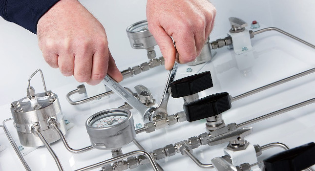

Improperly installed tube fittings. To reduce the likelihood of leaks and enhance plant safety, installers must properly assemble tube fittings. Technicians should be trained in how to make up a fitting by orienting the ferrules properly, tightening the assembly to specifications and using a gap inspection gauge to verify their work (see Figure 1).

It is helpful to train — and retrain — engineers and technicians in leak detection and prevention to enhance their skills. Training may include educating them on proper material selection, as well as holding hands-on, skill-building courses that cover tube bending and tube fitting installation procedures. By focusing on identifying and stopping leaks, these skilled professionals can help plants realize safer, more cost-effective operations (see Figure 7).
