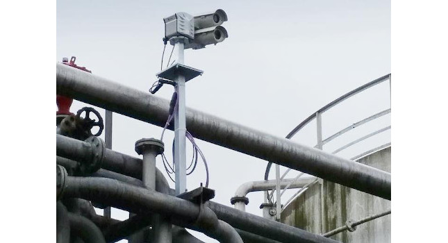

  • Installation of an early fire detection system consisting of a fully automatic infrared measuring system from DIAS Infrared, which detects a possible fire event via temperature changes on the surfaces of different materials even before a fire can occur. In particular, the safety devices of the tanks, various pumps and motors, as well as the refueling systems on the factory premises are monitored. The system consists of seven thermal imaging cameras mounted on pan-tilt heads. If a certain temperature value is exceeded, this is immediately reported to the control room of the tank farm and to the local fire brigade. The cameras are surrounded by a weather-proof housing with ventilation and heating (fig. 1). Thus, they are well protected against external influences. This set of measures also includes remote triggering of the extinguishing agent supply from the control room and automation of safety equipment.

The alternative fire protection concept was agreed and implemented with the operator of the tank farm, the responsible municipal authority and the local fire brigade. Early fire detection with thermal imaging cameras in conjunction with additional measures to optimize the fire protection infrastructure is now a central component of damage control. The operator is thus well equipped to face possible fire scenarios early and effectively in cooperation with the professional fire brigade – even in the event of a power failure and blocked access by a freight train (see fig. 2 and fig. 3).
