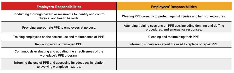

Employers are responsible for conducting a thorough hazard assessment to identify and control physical and health hazards, providing appropriate PPE, training on its correct use and maintenance, replacing worn or damaged PPE, and updating the effectiveness of the workplace’s PPE program. Providing PPE is not enough; employers must also enforce its use and evaluate the adequacy of the equipment in relation to the evolving workplace hazards.
While employers are responsible for providing and maintaining PPE, employees also play a crucial role in ensuring their own safety. OSHA standards emphasize that employees must wear PPE correctly to protect themselves from injuries and exposure to harmful substances in hazardous environments. Employees are also required to attend training sessions on PPE use, covering aspects like donning and doffing procedures, and understanding what to do in case of PPE malfunction. Moreover, workers are responsible for cleaning and maintaining their PPE, and informing their supervisors when there is a need to replace or repair the protective equipment.
Although employers and workers have different responsibilities required by OSHA, they are both involved in a critical aspect of PPE programs: the PPE assessment process. This involves identifying potential hazards in the workplace and determining the appropriate type of PPE needed to mitigate these risks. The assessment should be comprehensive, involving employer and employee input, and should be regularly updated to reflect changes in work processes, equipment, and external regulations.

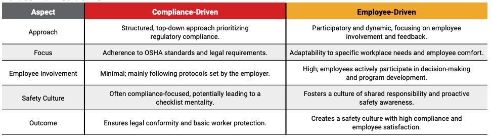

The challenge of ensuring consistent use of PPE in the workplace calls for innovative strategies that strike a balance between the structured approach of compliance-driven programs and the participatory nature of employee-driven programs. Such a combination approach would include the strengths of both models for legal compliance while also fostering a workplace culture where employees feel involved and invested in their safety.
For instance, a combined strategy could involve setting up a compliance framework based on OSHA standards, within which employees participate in selecting and evaluating the PPE. This could be facilitated through joint committees comprising both management and employee representatives to make sure the selected PPE is not only compliant with regulations as well as practical and comfortable for the workers. Training programs could also be designed to blend formal compliance education with peer-led sessions, where experienced workers share practical tips and insights, making the learning process more relatable and effective.
Table 2: Compliance Versus Employee-Driven PPE Programs
Incorporating technology, such as digital feedback tools or apps, can bridge the gap between compliance and employee-driven approaches. These tools can provide a platform for employees to report issues, suggest improvements, and receive updates on PPE usage and safety protocols. This ongoing dialogue creates a sense of ownership among employees, encouraging them to adhere to PPE protocols not just as a compliance requirement but as an integral part of their daily work routine.
By combining the structure of compliance-driven programs with the adaptability and employee engagement of employee-driven approaches, organizations can create a robust and resilient safety culture that not only meets regulatory standards, but also protects and values its workforce.
