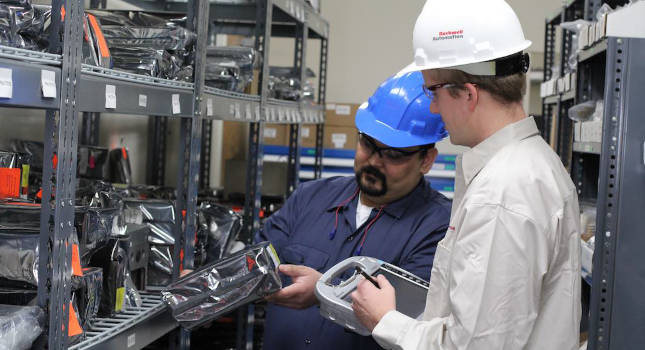

Figure 2: Working with the plant’s third-party technology suppliers, manufacturers can negotiate inventory levels to ensure sufficient spares are available in the storeroom and off-site. Courtesy: Rockwell Automation

Working with the plant’s third-party technology suppliers, manufacturers can negotiate inventory levels to ensure sufficient spares are available, either in the storeroom, an off-site location or both. Quantities are dictated by the installed base, criticality of the operations the automation supports, and availability of the specific part.
For example, if the plant has 100 units of a specific part number, then the storeroom would need approximately 10 units to support the installed base, or possibly 15 units for critical applications. Off-site stock can be protected for a specific company’s use only, thus ensuring availability when needed.
