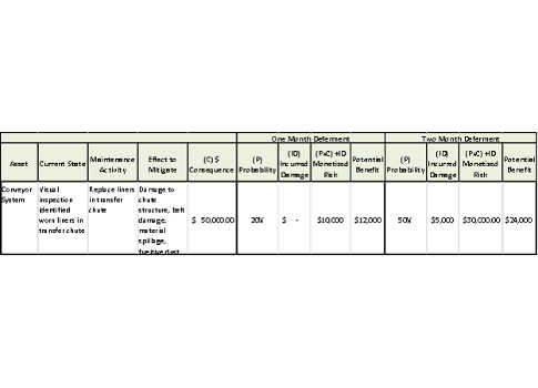

A simple example to illustrate the analysis is outlined in Figure 1. In the example, a visual inspection identified worn/thin wear liners in a conveyor-system transfer chute. To correct the issue, a replacement of the wear liners is required.
The operations manager asks the asset manager to defer the maintenance to meet the production schedule, which is valued at $12,000/month. Deferring the maintenance by one month increases the probability of failure by 20% at a cost of $10,000. Deferring by two months increases it to 50% and incurs $5,000 worth of damage to the chute structure for a total cost of $30,000. Based on the analysis, the asset manager decides to defer the maintenance by one month, as the increased risk of deferring by two months outweighs any potential benefits.
