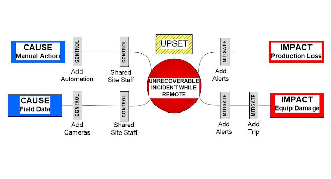

MOOC methods and visualization
Most MOOC studies have relied on what-if scenarios, impact checklists and brainstorming. Using these tools can be effective if the scope of deliberation is broad enough and is facilitated in an open environment. Perhaps the best tool to help visualize the status is the bow-tie method, which is often used in safety studies. Bowties are constructed with “causes” on the left and “impacts” on the right with control and mitigation elements aligned with each entry (see Figure 2).
In this example, the causes (or threats) and impacts (or consequences) related to an “unrecoverable incident while remote” is shown. Example upsets are shown on the left and impacts on the right. Preventable controls are shown between the causes and the unrecoverable event in the center. Mitigation barriers are shown between the unrecoverable event and the impacts.
It can be effective to brainstorm in a general structure, where items that control or mitigate are grouped with existing and new ideas. Easy to use software exists for bowties, but simple Visio or Microsoft Excel tools also can be leveraged. Try to not let the use of the tools slow the brainstorming or add too much complexity early in the development of the ultimate recommendations.
