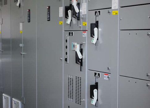

The installation of large, medium-voltage VFDs in mechanical equipment rooms creates the problem of harmful ambient room temperatures. This means facility managers and plant engineers must mitigate the heat generated by VFDs. The room temperature must remain low enough not to harm equipment and to meet OSHA standards for technicians who must operate or maintain equipment in the room.
Most electrical equipment of this type is specified to operate at a 104°F ambient air temperature, which may be too warm for operators working over an extended time. Automation and computer equipment, which share the equipment room, may not be rated to operate at these temperatures.
