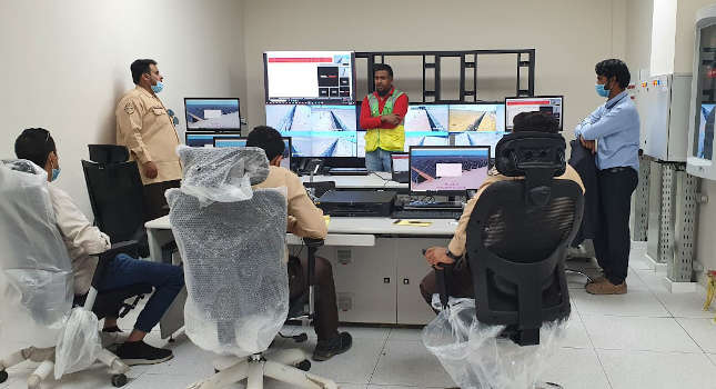

  • IT hardware: video wall and workstations (see Figure 2)

The SAT process required remote collaboration and countless conference calls, and video recordings of tests were maintained as part of the SAT report (see Figure 4).
With careful team coordination, along with the support of the end user and after three months of hard work, the site was finally ready for inspection and approval. The inspection was successfully carried out on June 10, 2020, in accordance with High Commission for Industrial Security guidelines and handed over to the end user representatives. Operation training was imparted to the site operators and were made aware of all the features and guided to avoid any mishandling.
