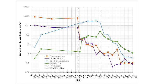

The impressive results that bioremediation delivers aren’t a fluke or happenstance; they’re consistent and impactful. As an example, a manufacturing facility in Arkansas contaminated with chlorinated solvents implemented in situ bioremediation through subsurface injection of emulsified vegetable oil (biostimulation) and reduced contamination by more than 99% in about four years. Similarly, in another former manufacturing site in North Carolina contaminated with chlorinated solvent contamination and low pH (~ 3) in groundwater, the contaminant concentrations were decreased approximately 90% in about seven years with the implementation of biostimulation, bioaugmentation, and pH buffer injection.
