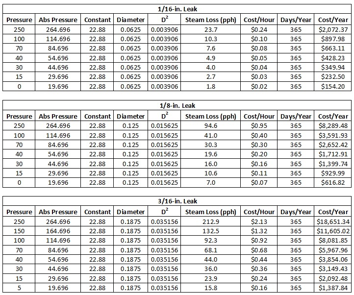

Through its research and testing, SEA has found that by adding a leak constant to the Napier orifice equation, it can estimate a conservative flow and energy loss from steam leaks.
The tables below show the estimated costs per year for steam leaks of 1/16 in., 1/8 in., and 3/16 in.
