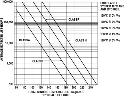

Of course, motors are not designed to run at the maximum allowable temperature, because that would drastically decrease motor life. In fact, every 10 C rise in operating temperature reduces insulation life by half. Therefore the ultimate design is one that optimizes motor life and function, while keeping the cost of production, maintenance and efficient operation as low as possible.
As an example, suppose that a motor with a 65 C rise (very conservative by most standards) is put in service on a hot summer day. If the ambient temperature is 35 C (95 F), the winding total temperature would be: 65 + 35 = 100 C. If motor is so constructed that its surface is about 20 C cooler than the winding, the surface temperature would be: 100 – 20 = 80 C (176 F)—i.e., much too hot to touch safely! Remember that this is a conservative design, so the surface temperatures of many motors will be much warmer.
