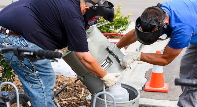

Since July, UW–Madison began funding its own surveillance program in conjunction with the WSLH, managed by Facilities Planning and Management. Samples are drawn twice weekly from sewers on Elm Drive and on Easterday Lane, offering a broad survey of employees and students, including those in residence halls. Collecting the sewage involves pulling directly from the wastewater supply, rather than from what flows into a large treatment facility.
“Samples on campus can be from within minutes of production so they are a bit messier,” Shafer said, adding, “We do it for the good of science and public health.”
