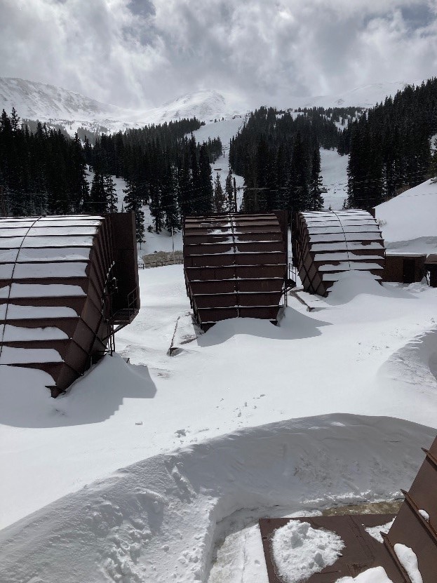

The engineering team was tasked with integrating replacement motor control centers (MCCs), new variable frequency drives (VFDs), programmable logic controllers (PLCs) and human-machine interfaces (HMIs) in each ventilation building electrical room and control room. There are 16 fans within the tunnels – both supply to push through the air and exhaust to suck out the air. The exhaust fans vent through the roof as seen in this picture.

The Eisenhower Tunnel (running East to West) and the Johnson Tunnel (running West to East) are required to be constantly equipped with a ventilation system that can evacuate smoke from the tunnels within 180 seconds. Courtesy: Huffman Engineering
