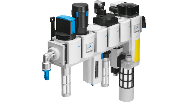

Many considerations of the pneumatic system are under the engineer’s control. These include air quality, tubing material, routing, size, component accessibility and availability.
Compressed air contains moisture, dirt particles, and oil. Any one or combination of these contaminants can degrade pneumatic system performance. Building in air filtration – referred to as air preparation systems – that meets the performance specifications of the components in the system. Refer to ISO 8573-1 Compressed Air –Part 1: Contaminants and Purity Classes as an important design standard. Once the desired air purity for the components is determined in terms of concentration of dirt, water, and oil in the air. There are software programs that can identify the specific air preparation filters required to reach those levels.
Tubing is just as important in design consideration. For example, harsh chemicals or corrosive compounds in the environment can cause tubing to crack and leak. Specify the best material for the environment. Long runs of tubing reduces air flow. The goal is to create the shortest, straightest runs from air preparation unit to valve. If it is impossible to shorten a run, increase tube diameter to compensate. Kinks and bends reduces the internal cross-sectional dimension and reduces flow. Increase diameter as appropriate to achieve desired flow.
