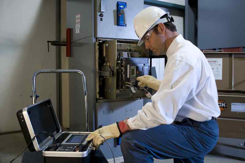

When faced with the repair versus replace dilemma, facility managers may now opt to modernize the existing switchgear lineup. As previously stated, both passive and active components require routine preventive maintenance to help optimize equipment reliability. As a rule, the passive components have a longer life than the active components as their structure is typically less complex.
So, why replace the entire structure when problems arise? A more cost feasible alternative would be to leave the switchgear structure and bussing in place and upgrade the active components with the latest state-of-the-art circuit breakers.
Direct replacement and retrofill modernization solutions are available for adapting the latest technology circuit breakers into a switchgear or switchboard. These solutions are available to replace a variety of low-voltage and medium-voltage OEM circuit breakers. Both options are designed to improve reliability, reduce maintenance, and increase equipment capabilities.
  • Direct replacement: Via an adaptor cradle, direct replacement circuit breakers are designed to fit into the existing switchgear cubicle with little-to-no modification to the switchgear cell. Direct replacement solutions reduce downtime since there is minimal (if any) outage on the equipment bus.
  • Retrofill: The existing switchgear cell and bus are reconfigured to accept the new circuit breaker. This option requires a longer bus outage since the internal cell is being modified.
For both the direct replacement and retrofill modernization solutions, new cubicle doors are provided to match the existing equipment and new circuit breaker face. Designs are available for any manufacturer’s switchgear.
