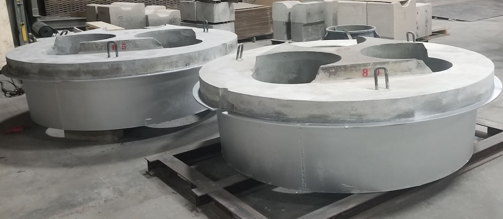

A high-quality refractory precast shape is crafted from premium refractory materials and tailored to match the geometry, thermal and chemical requirements of the specific application. A top-notch shape showcases outstanding resilience against thermal shock, erosion and corrosion. This durability ensures an extended service life, even amidst challenging conditions.

  1. High-quality refractory material: The use of premium refractory materials with optimal thermal and chemical properties ensures superior performance and durability in high-temperature environments. Quality refractories exhibit well-defined microstructures that enhance thermal stability and mechanical strength, reducing the likelihood of cracks. By utilizing high-grade refractory materials, precast shapes can withstand heat, insulate efficiently and endure harsh conditions. This enhances the longevity, efficiency and reliability of industrial processes.
  2. Precise dimensional accuracy: A pivotal attribute in refractory precast shapes, precise dimensional accuracy is crucial for their effective performance. These custom-designed components need to fit equipment in industrial settings, preventing gaps and ensuring optimal heat retention. This accuracy enhances thermal efficiency and structural integrity, reducing the risk of heat loss, uneven stress distribution and premature wear.

The installation of refractory precast shapes holds significant importance in ensuring the shapes optimal performance and durability. Even the highest-quality precast shapes can fail to deliver their intended benefits if not correctly installed. The precise placement and secure attachment of these shapes within the equipment can ensure minimized gaps and seamless integration, essential for effective heat retention and uniform thermal distribution.
A meticulous installation process prevents potential weak points, which could compromise structural integrity and lead to premature wear or even catastrophic failure under thermal stress. Proper installation contributes to efficient energy utilization, reducing heat leakage and enhancing overall operational efficiency. In essence, the careful and skilled installation of refractory precast shapes is an investment in operational reliability and extended equipment lifespan, optimizing industrial processes.
