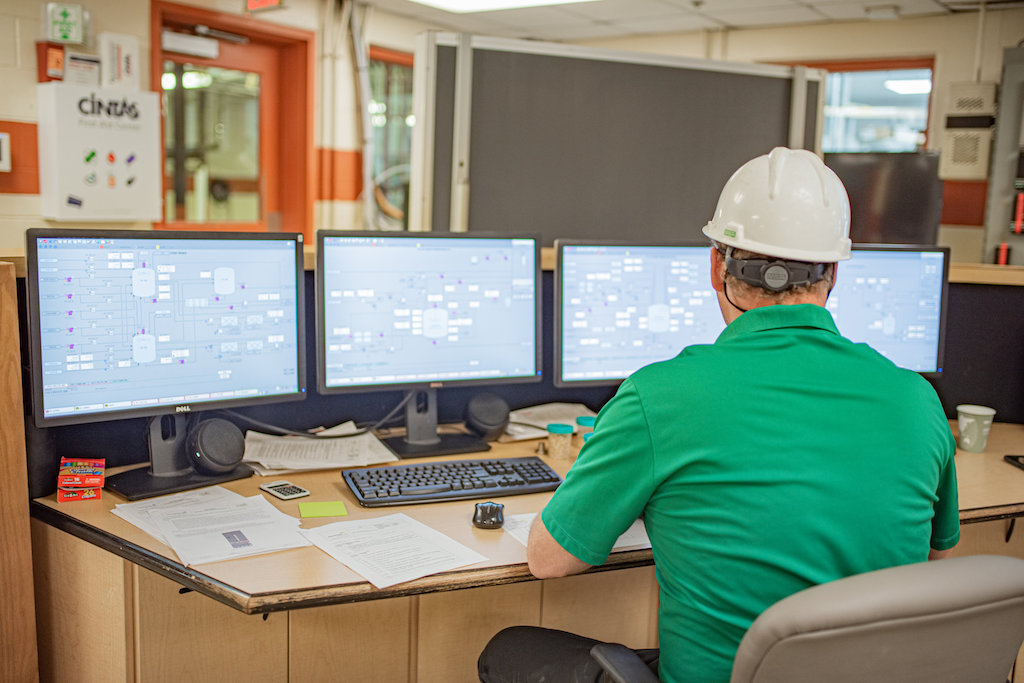

The Danimer Scientific facility in Winchester, Ky., is controlled by a DeltaV DCS batch system and uses a DeltaV Live operator interface also from Emerson. Courtesy: Hargrove Controls + Automation
Retrofit design offers technical challenges: DCS, HMI
The facility is controlled by a distributed control system (DCS) batch system upgraded to the latest operating system and includes a human-machine interface (HMI) rebuild and operator interface.  There is a plant-wide data historian which gathers information from the DCS. There are nearly a dozen third-party skids integrated together into the DCS, which was a significant part of the effort. Many of the skids are on the finishing unit, which takes the output of the clarification and sends it to the centrifuge, dryer, and pelletizer.
