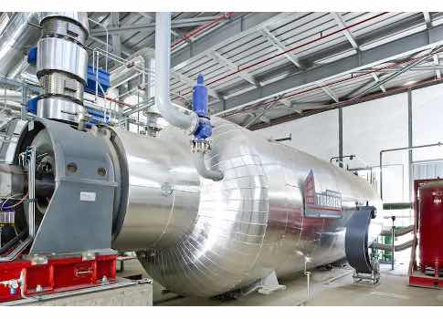

Italian firm an industry leader
One of the leaders in the development and promotion of ORC technology is Turboden, a group company of Mitsubishi Heavy Industries. The company is headquartered in Brescia, Italy and markets this technology worldwide. Turboden has manufactured turbogenerators using ORC technology since 1980, and offers systems ranging in size from 200 kWe output up to 3 MWe. They have extensive experience using byproduct heat streams from industries including cement-making, glass furnaces, forest products, and electric generation using exhaust streams from engines and combustion turbines.
Clotilde Rossi de Schio is Manager for Sales and Development for Turboden in North America. She points out that these turbogenerators take advantage of the lower temperature limit for economic energy extraction. "In order to give a general indication, a ballpark figure can be 100 C [212 F] for liquid sources and about 140 C [284 F] for exhaust gases." This is significantly lower than is practical with a water/steam cycle.
Wide range of industrial heat sources
A wide range of industries have potential for electric generation using byproduct heat. Rossi points out, "Typical industries that are looking for heat recovery options are energy intensive industries such as cement, steel, aluminum, refractories, glass and chemicals. Another attractive source is as a bottoming [final heat recovery] cycle for gas turbines and gas engines." She adds, "Any heat source in the form of gas, liquid or steam can be a good candidate for heat recovery, independent of where the heat is coming from."
She notes, "Turboden utilizes different families of organic fluids, depending on client needs and preferences (e.g. non-flammable) and on thermodynamic properties. They can be siloxanes, hydrocarbons or refrigerants. They are typically used at operating temperatures far from their cracking points, therefore we can consider their lifetime to be 20+ years."
Proven reliability
Because of the relatively long experience with this technology, and the fact that these turbogenerators operate at relatively low temperatures, they are highly reliable. Rossi indicates that Turboden’s experience is that with all installed units, average availability is greater than 98%.
She explains that units can be operated automatically and are normally unmanned. An annual service of one week per year of predictive maintenance is recommended. Turboden’s website includes a calculator to provide an estimate of the power generation potential of various thermal streams, with the input of character, volume and temperature of the stream.
