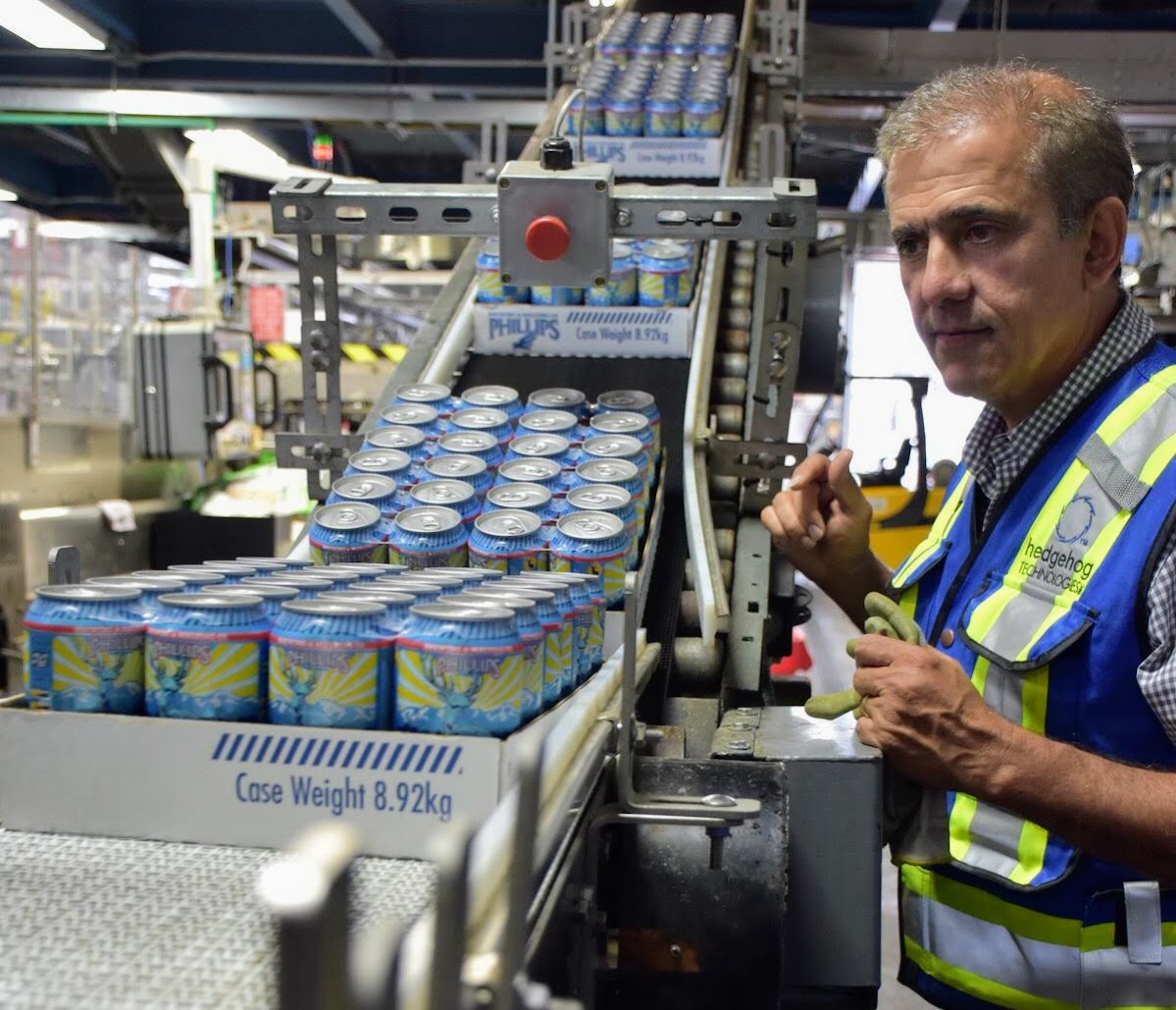

Figure 1: Pneumatic and hydraulic systems in a manufacturing plant setting. Courtesy: Hedgehog Technologies Inc.
It is also important to consider the potential for physical harm when working with pneumatic and hydraulic systems. These systems are often implemented to move large objects quickly and precisely and as a result they can generate large amounts of force over short intervals. Entrapment is a potential risk in this situation; clothing or limbs can be caught in the moving parts of the mechanism, which can cause serious injury or death.
Workers must be trained to properly use and maintain pneumatic systems to minimize the risk of injury. Proper training, including hands-on training with the specific pneumatic systems in use, can help workers to understand the potential hazards and take the necessary steps to stay safe. This can include training in following the proper safety guidelines and regulations, using proper protective equipment and following lockout/tagout procedures to prevent accidental activation of equipment during maintenance or repair.
