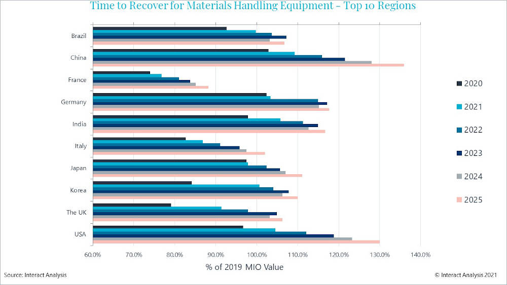

Materials handling equipment can be split into four separate sub-groups: conveyors, which take up 30% of the market, escalators and lifts (30%), cranes and hoists (25%) and forklifts and other industrial trucks (15%). The fortunes of the materials handling equipment (MHE) sector are closely linked to those of general industrial production. This means as the global recovery accelerates, MHE will see concurrent growth. And this growth will be from a relatively strong base, given that it saw modest contraction in 2020 of only -3.8%. The sector will see 6% growth in 2021. One of the motors behind this will be the drive for greater industrial automation. Another is the sector’s universality: MHE is used across a wide range of industrial sectors.
Regionally, the biggest producers of MHE are China (43.6% in 2019), the USA (10.8%) and Japan (8.5%). We expect most of the top ten regions to recover by 2025. For example, the market in China grew by a modest 3% in 2020, and will see 6.2% growth in 2021. In contrast, the data shows that the worst performer on most MHE counts will be France.
The materials handling equipment sector is headed for a swift recovery. Courtesy: Interact Analysis
