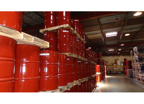

2. Storing lubricants outside
Never store your lubricant outside. Temperature changes cause the air volume in the storage container to change. As temperatures fall, air condenses and can pull in moisture if drums are stored vertically outdoors. This puts your lubricants at an increased risk of oxidizing before being put into service. The best place to store your industrial lubricants is inside in a dry, clean area at ambient temperature.
