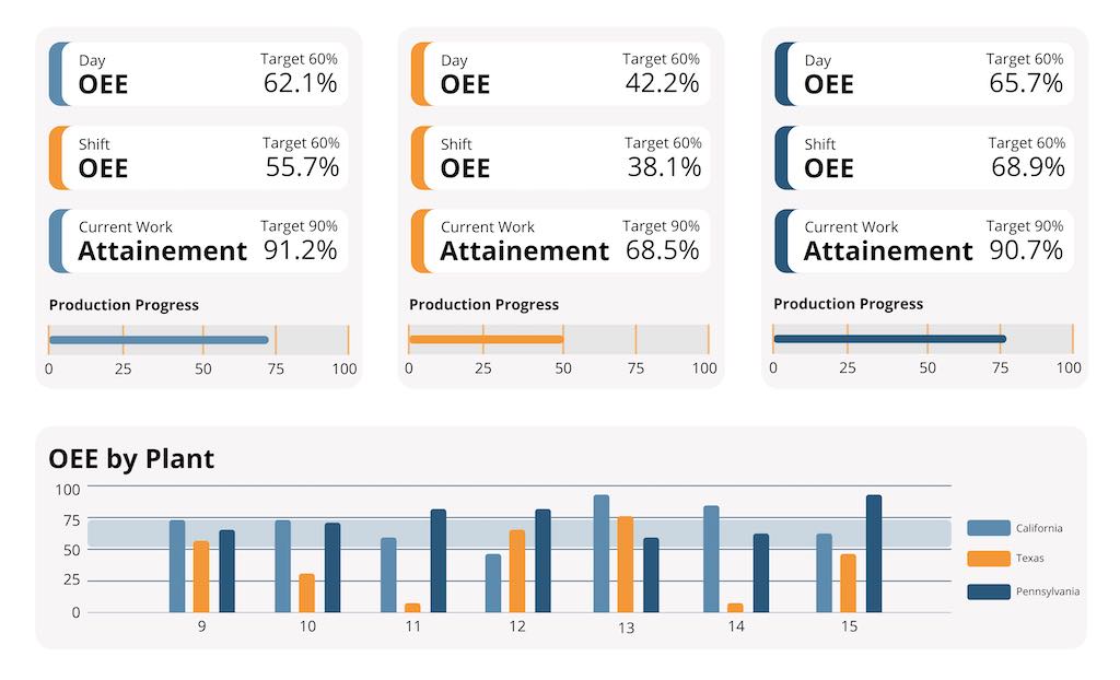

The implemented technology served as a digital platform that helped integrate, aggregate, contextualize, display and report actionable insights. Multiple solutions were implemented using this Digital platform over a four-year period. Each phase delivered a return on investment (ROI) that helped fuel the subsequent phase. Phases included the following:
Performance management for three filling lines with automatic data collection from more than 10 PLCs and using standard user interfaces, dashboards, and reports. Several PLCs were upgraded to have EtherNet/IP capability. The PLC system tracking file captured machine state, production/reject counts and the first fault for each machine.

Scoreboards across many machine centers for real-time shift performance.

Out-of-the-box user interface screens, dashboards, and reports available on tablets, large production monitors, office computers, and mobile devices
