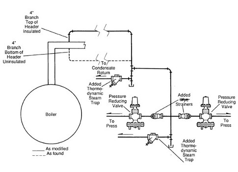

Consider, for example, a problem that recently occurred in a fiberboard manufacturing plant. Two pilot-operated pressure-reducing valves were regulating steam pressure to presses. Although initial operation was satisfactory, within a fairly short period the operator noted swings in the regulated pressure, most noticeably a tendency to overshoot the setpoint. The valves had also apparently lost their ability to shut off tightly.
The valves were disassembled, and the heads and seats were found to be eroded, causing leakage and overshooting. New trim was installed under warranty and the valves were put back in service. Before long, however, leakage and overshooting began again. Although the next alternative seemed to be to replace the installed valve with that of a different type, the decision was made to first review the entire system and installation.
This investigation revealed several design problems, which together caused premature valve failure. First, the branch line was taken from the bottom of the boiler header, rather than from the top. Second, none of the distribution piping was insulated. Third, no steam traps were installed in the distribution piping between the boiler header and the valves. These anomalies allowed the steam distribution piping to become flooded with condensate. Remembering that a valve designed to operate on steam cannot be expected to work at its best when supplied with a mixture of steam, water and dirt, failure in this situation was attributable to design problems.
In practice, steam often carries tiny droplets of water and cannot be described as dry, saturated steam. The droplets, when forced between the head and seat of a partially opened valve, can lead rapidly to wire drawing (the cutting action of high velocity steam and water passing through a partly opened valve) and the need for expensive replacements. Aseparator, drained through a steam trap, will remove almost all the water from the steam entering a pressure-reducing valve.
Dirt can keep a valve from shutting off tightly. Installing a simple pipeline strainer prior to every reducing or regulating valve solves this problem.
To resolve the problems found at the fiberboard plant, the steam system was modified as shown in Fig. 1.
The branch line takeoff was moved to the top of the header, where the steam is driest. All the distribution piping was insulated, and drip traps were installed at the bottom of each vertical pipe run. Strainers were also installed upstream of each of the pressure reducing valves.
After the modifications were completed, the pressure reducing valves held the steam pressure constant at the setpoint. Not only was the valve problem solved, but the efficiency and productivity of the presses were increased, since they were being supplied with clean, dry, saturated steam. Furthermore, total steam usage decreased because the heat was being transferred effectively.
