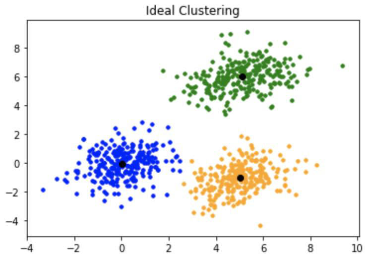

- K-means
The K-means algorithm sorts data into K clusters, where the value of K is preset by the user. At the beginning of the process, the algorithm randomly assigns K data points as the centroids for the K clusters. Next, it calculates the means between each data point and the centroid of its cluster. This results in a resorting of the data into the clusters. At this point, the algorithm recalculates the centroid and repeats the means calculation. It repeats the process of recalculating the centroid and re-sorting the cluster until it arrives at a constant solution (see Figure 1).
The K-means algorithm is simple and efficient. It is very useful for pattern recognition and data mining. On the downside, it requires some advance knowledge of the dataset to optimize the settings. It is also disproportionately affected by outliers.

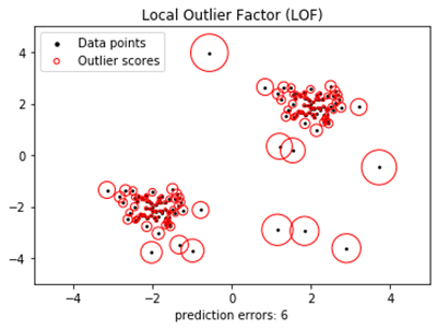

- Local outlier factor (LOF)
One of the challenges in identifying outliers by distance from the centroid alone is that a data point that is a short distance from a small cluster can be an outlier, while a point at a seemingly large distance from a large cluster may not be. The LOF algorithm is designed to make this distinction.
LOF defines an outlier as a data point whose local density deviation is much larger than that of its neighboring data points (see Figure 2). Although, like K-means, it does require some user settings in advance, it can be very effective. It can also be applied to novelty detection when used as a semi-supervised algorithm and trained only on normal data.
