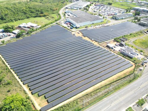

Figure 2: The clean energy project at Eaton’s Arecibo facility is strengthening energy resilience in the face of climate change, with extreme weather events becoming more common. Courtesy: Eaton.

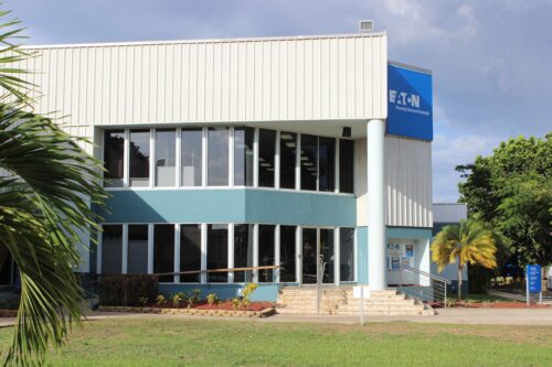

Decarbonization in action at Eaton’s Arecibo manufacturing facility
We recently completed clean energy projects at our Arecibo manufacturing facility in Puerto Rico, where we make circuit breakers used in homes, buildings and industrial applications. Here are two takeaways from those projects. 1. The best energy is the energy you don’t use, and we took action to drive energy efficiency at the site. 2. A solar-plus-storage microgrid gives new control over our energy supplies and costs, incorporating 5 megawatts (MWac) solar PV and approximately 1.1 MW of battery storage (along with existing onsite generators). Together, these measures are boosting resilience, driving energy use down 45%, cutting emissions by 7,100 metric tons and substantially boosting our resilience while reducing the facility’s annual energy spend by nearly 20%. Importantly, the microgrid’s ability to withstand a Category 5 hurricane ensures critical manufacturing operations can remain online in the face of extreme weather conditions. The Arecibo microgrid balances energy from various sources, including onsite solar panels, energy storage systems and existing backup generators. This flexibility allows the facility to maintain operations even during grid outages, effectively “islanding” itself from external disruptions. During normal operations, the microgrid generates renewable energy that can be stored, consumed onsite or even fed back into the local grid, helping to reduce strain on regional infrastructure while cutting our energy costs. The focus on sustainability at our Puerto Rico facilities is part of our broad initiative targeting a 50% carbon emissions reduction by 2030, aligning with science-based targets. Our approach incorporates various initiatives, including energy efficiency upgrades, plant engagement to reduce energy usage, onsite distributed energy resources, offsite renewable sourcing and green supply contracts.
