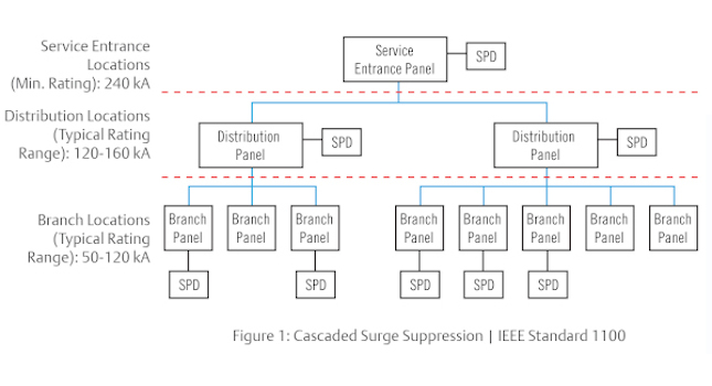

Cascading surge protection, in-depth
To optimize suppression throughout a system, SPDs should be installed at all levels of the electrical distribution system. This is known in the electrical industry as cascading or layering. IEEE refers to it “protection in depth.”
Cascaded surge protection provides additional suppression from large transients, that step their way through from the service entrance, by further reducing the let-through voltages. Also suppressed are more frequently generated internal transients.
Let-through voltage is the voltage appearing on the equipment side (load side) of an SPD when an impulse voltage/current of a defined wave-shape and amplitude is applied to the line side of an SPD. It can be used to compare different SPD’s abilities to lower the surge voltage to the equipment requiring protection.
IEEE Standard 1100 recommends cascading levels of protection from the service entrance to distribution and branch panels, and even protection for individual critical loads. The closer to the service entrance, the more robust the device should be rated. This protection in-depth strategy protects the facility and critical loads. In recommending a kA per phase rating a general rule of thumb – “the 3-2-1 rule of thumb” applies: The service entrance should be 300 kA, distribution panels 200 kA, and finally branch panels can be 100 kA per phase.

Recommendations: SPD ratings
Choosing the appropriate surge rating for an SPD comes down to two things: 1) the location of the SPD within the electrical distribution and 2) the facility’s geographic location.
Location kA
Service panel 300kA/phase
Distribution panel 200kA/phase
Branch panels 100kA/phase
Emerson recommends the above surge current ratings based on SPD location within the electrical distribution using the general “3, 2, 1 Rule of Thumb” mentioned earlier.
Larger, more destructive surge currents are mostly found at the facility service entrance. On rare occasions, if, for example, the exposure level is “extreme” as in states like Florida, it might be wise to increase surge current ratings. In these cases, the SPD will be exposed to larger surge events more frequently.  With the correct surge current rating for your application, the SPD can then be exposed to a higher number of surge events before needing replacement. In addition, SPD event counters come standard on some models to monitor events for these types of locations.
Experience with SPD products shows that a device carrying a surge current rating between 240 and 250kA for a service panel or critical load provides many years of service in “high to medium” exposure locations over time.
