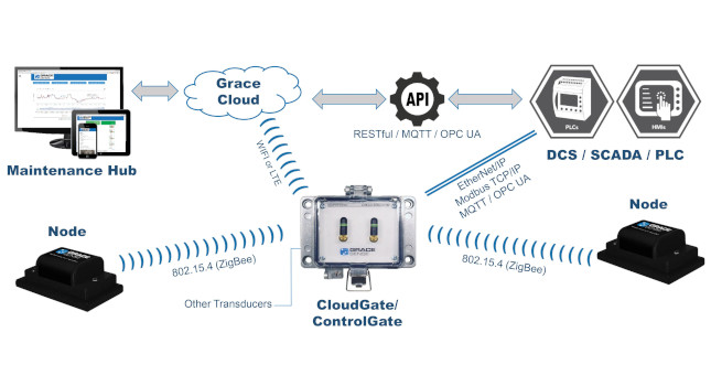

According to the manufacturer’s maintenance manager, the integration and application of a solution was quick and simple, and the cloud-based capabilities were particularly useful. To ensure that the system could be integrated with their programmable logic controller (PLC) network, solutions can work with manufacturers to develop a solution that would allow data to be transmitted from the predictive maintenance system using both cloud and PLC networking.
To support this application, the manufacturer installed gates to communicate with their 140 vibration and temperature nodes, which are wireless sensors that monitor vibration and temperature to assess the health of rotating equipment. The IIoT application engineer team provided node and gateway installation oversight and performed a site survey to determine the best locations for the gateways. Once the hardware was installed, the application engineers worked closely with other manufacturers to provide PLC integration support.
